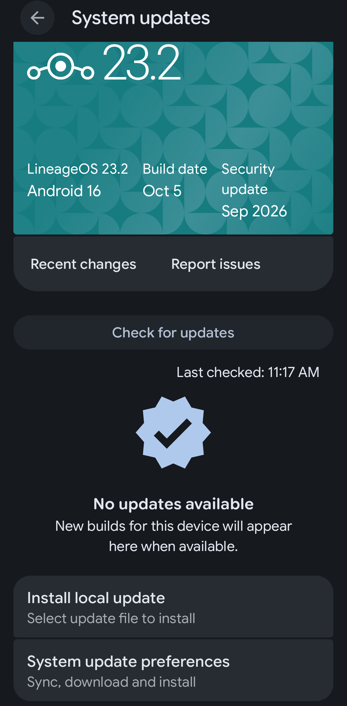

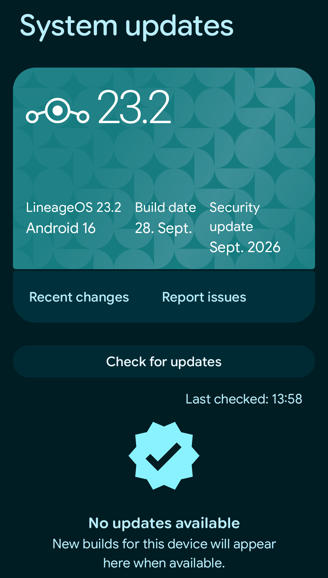

Hi,
I tried to install the lastest nightly build (28 of September). I am currently on the 14/10 build. The lineageos updater app shows ‘failed to check for update’ and trying to update from the push_update script (lineages wiki) doesn’t work either. It just says ‘update failed’. The same goes for a local update with the file from the LOS website.
Thank you for your help
The latest build is the one from October 5. You can probably check once again if you get it offered after a few tries. Another option would be to download it from LineageOS Downloads and do a local update
Tap “install local update” and select the downloaded “lineage-23.2-20261005-nightly-FP6-signed.zip”
Thank You for you answer.
I already tried doing that and got the same error message.
So, only dirty flashing or, as a last resort, clean flashing from recovery are the options left, I guess. Backup recommended in both cases.
