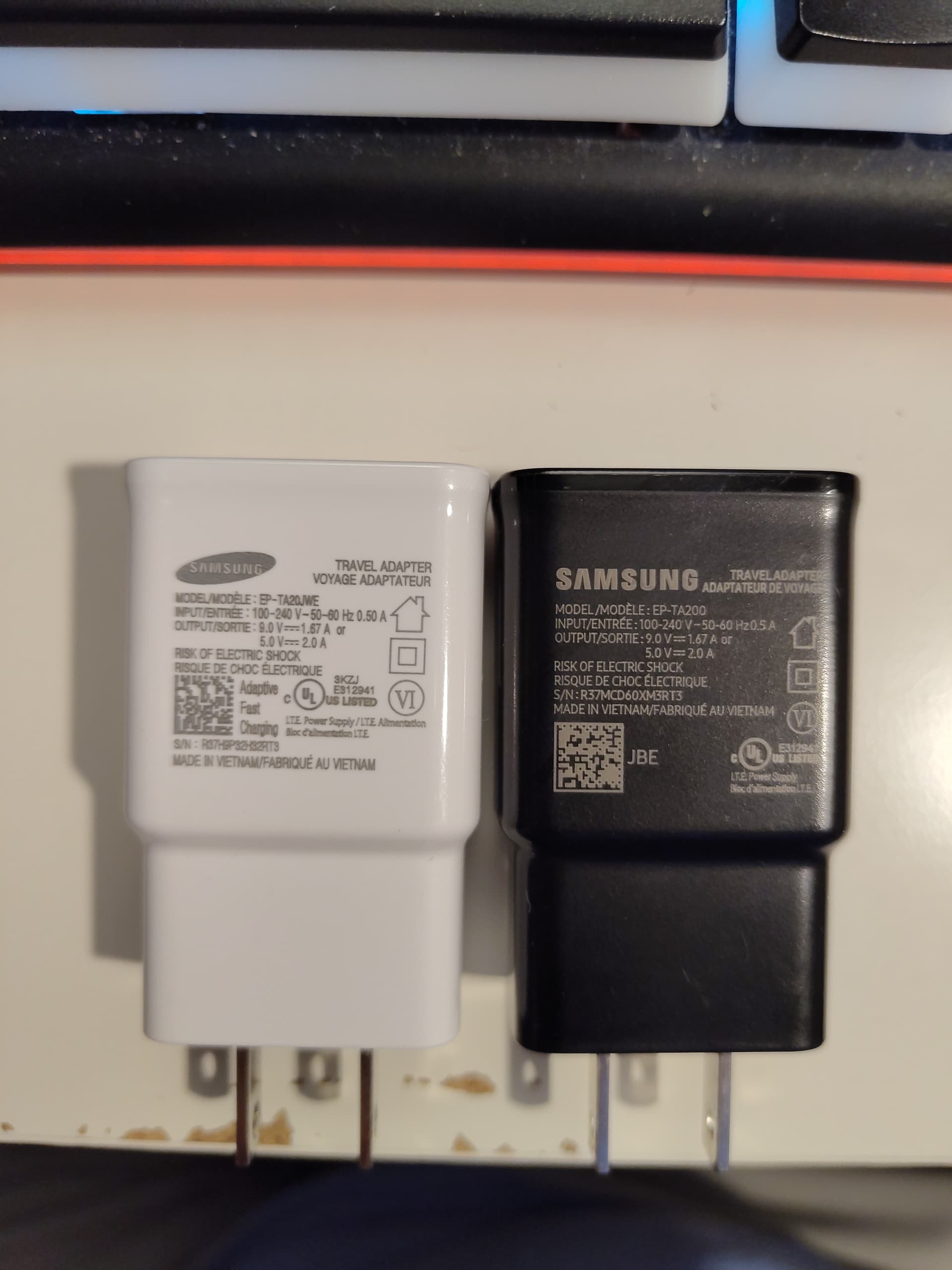

I had a similar problem. It turned out to be the charger I was using. I had two old chargers from some Samsung phones (when new phones came with chargers in the box).One worked and the other did not. They looked identical but were different models and i guess different certification for fast charge or adaptive charge abilities. I used a watt meter to see what was happening.

My phone looked like it was charging the battery symbol showed charging but the percent didn’t go up. I tried charging while the phone was off, and it did everything it should to show it was charging, but the percent was not going up. When I swapped chargers, everything worked.
The white USB charger on the left registers 10 watts on the meter while charging. The black one on the right goes from 10 watts to zero with a second or two. The battery icon on the FP6 shows the phone is charging and the battery menu shows a time to full, so it is charging. Just really slowly at less than my watt meter can measure. These chargers are different models and from different generations of Samsung phones. I assume it has to do with what version of adaptive charge they are capable of. I used the came charge/data cable during the test.
