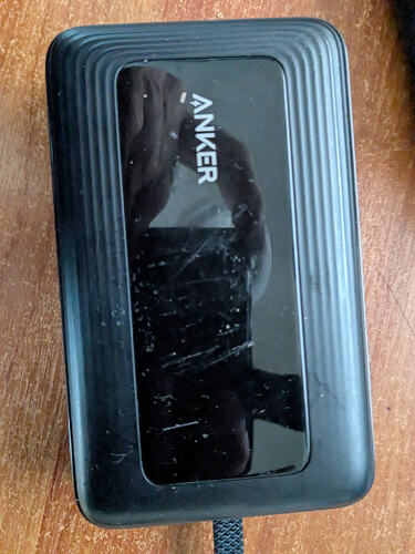

I’m using these two Anker charger and battery pack. See attachment. Normally charging with these apparatus doesn’t give any problems. Only with the battery is drained this kills the phone.
What would you advice me?

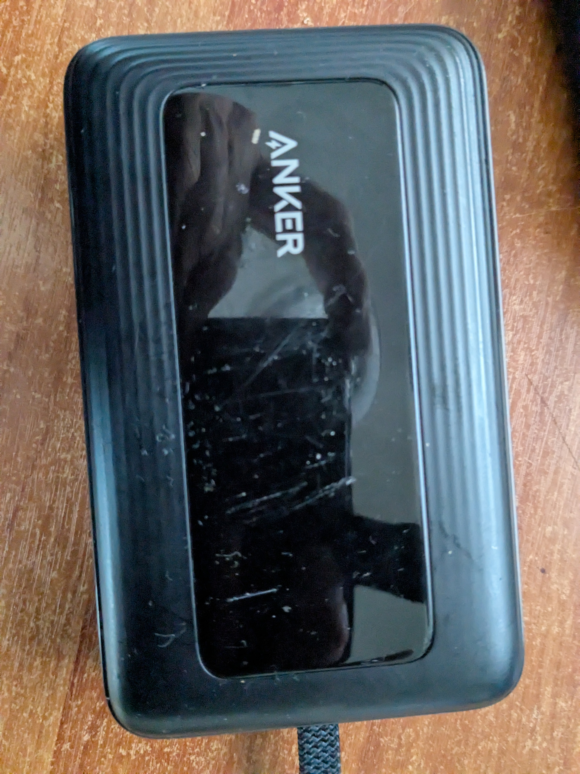

This Anker charger is the same that killed my FP6 three times and I’ve seen it mentioned by other people in this here thread. FP should really investigate why it doesn’t play nice with the FP6. No problem with my other devices btw. I’m sending mine in to get a full refund now, which will be issued once the repair center has determined that this wasn’t my fault.
