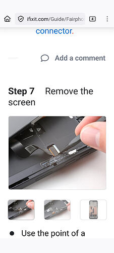

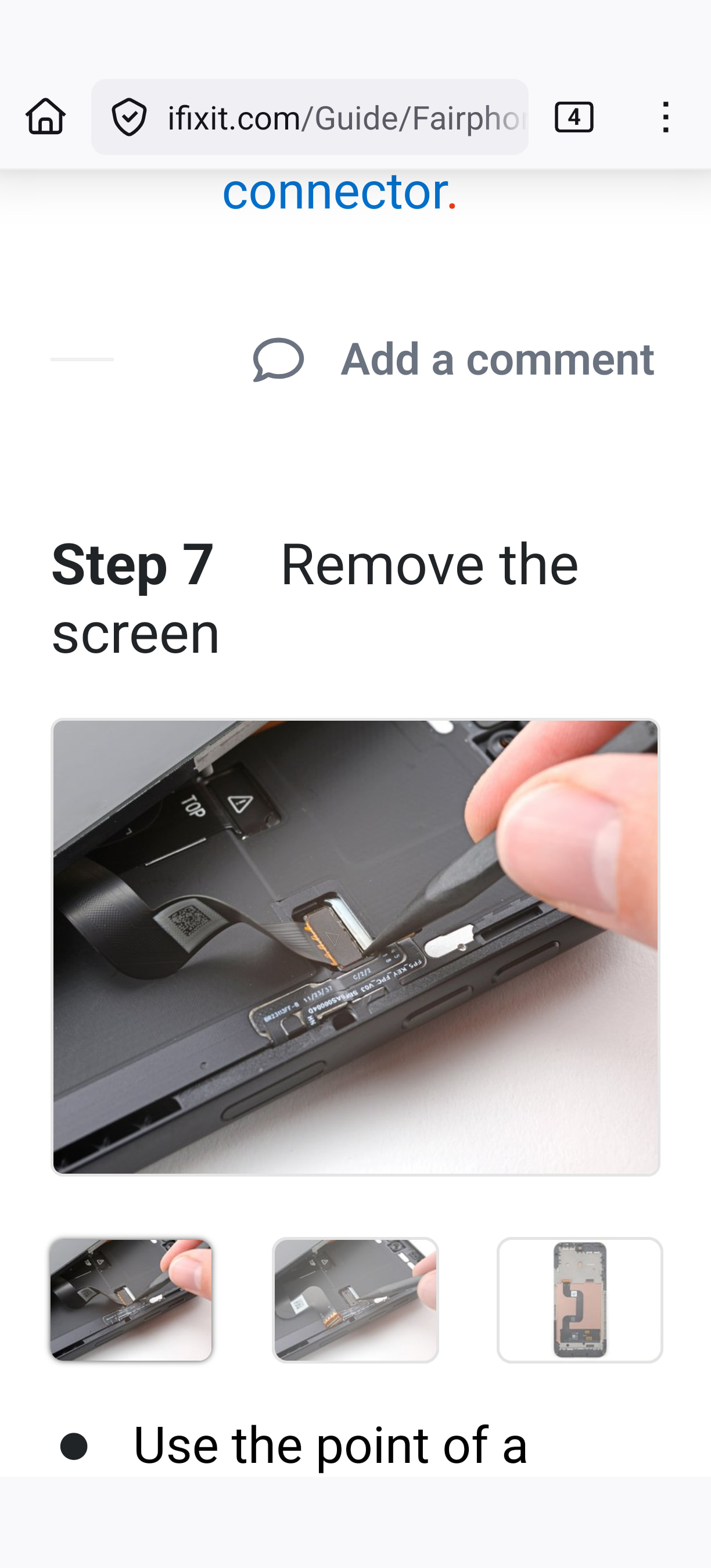

I am not sure when this picture was taken but connectors do not seem right.
This is the picture from the ifixit guide, which shows disconnecting the display but hopefully it can show what I mean, the connector should be lying flat.
There are also video guides on FP5 website.
Thanks! I see what you mean, I’ll check it out.

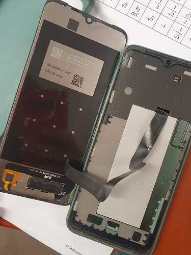

Hi Elisabeth,
according to your picture of the FP4 the frame of the display is still attached to the phone body. If you disassemble the frame from the body as described in
you can check if the connection cable is still attached correctly to the connector and undamaged. If the cable is okay and just pulled out of the connector you may put it in again, assemble the phone and try if the display is working again. If so, you may fix it with transparent tape at the top (might blur your photos :wink:) and bottom of the display and order a new display while using the taped phone in the meantime.
