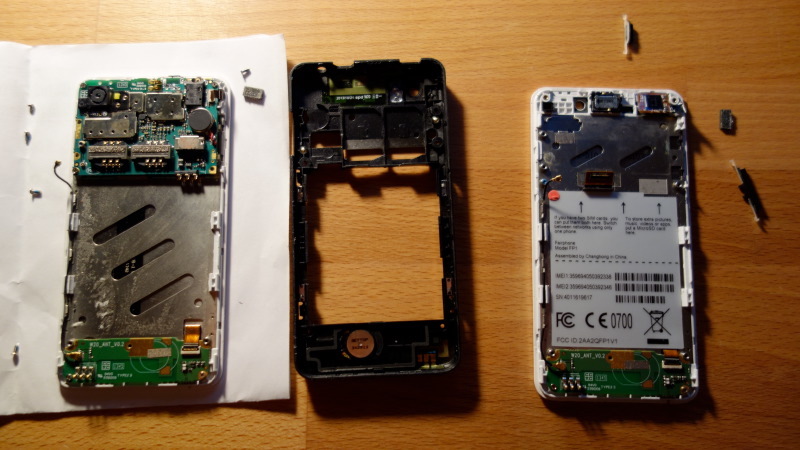

The used FP1 and the FP1U display and on the left side my still working FP1U with the iFixit manual on it.
The used FP1U display came with antenna, motherboard, earpiece and daughterboard on it, but I knew the USB-port was defect and the camera was missing. So I took off the motherboard but left antenna, earpiece and daughterboard on it and started to disassemply the used FP1 once again.
I transferred the motherboard, camera, power- and volume-buttons from the FP1 to the display assembly of the FP1U, closed it with the midframe, added the battery, pressed the power button and voila: it came to live! :grin: :monkey: :fireworks:
So now I had a complete well functioning Fairphone hybrid in my hand: FP1U display assembly, earpiece, antenna and daughterboard + FP1 motherboard, camera, battery and midframe. I checked it calling, connecting to Wifi and taking pictures - all perfect! The only thing missing was the metal-back-cover as the FP1-seller gave it to some nostalgic 1st edition back-cover-collecter :smirk:

Once again I managed sucessfully te disassembly everything and thats how my own FP1U looked when before I started to reassemble all pieces on the brandnew display:

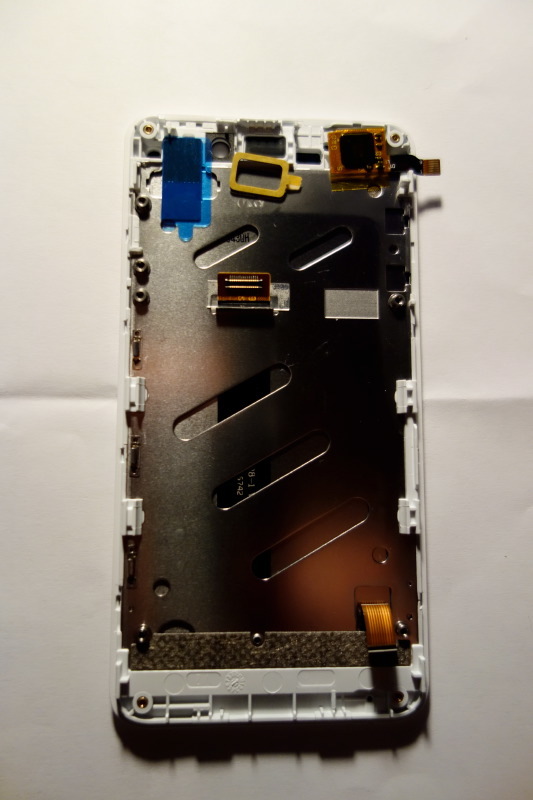

The new display came with a tiny rubber frame for the earpiece and with protection label on the adhesive were the camera-unit would be fixed. So I had to remove the old one from my earpiece and take of the blue label before putting everything together again.
Everything went very well and it even took less time and I worked very calm as I had good experience already from the former repairing/ merging action. In the end a little suspense again pressing the power button - big release: I did it! :relieved:
