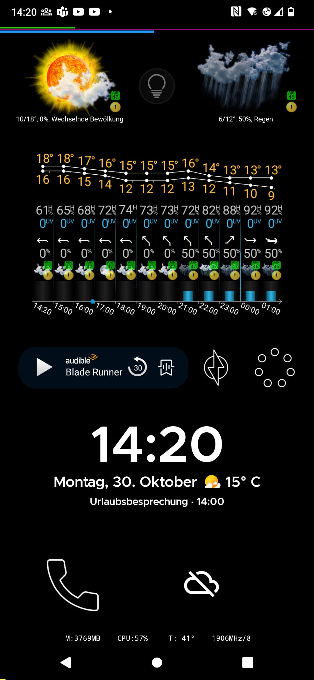

Hi, maybe the free app PowerLine (Google Play Link) might help?
It can display various parameters as lines on your display for a better visible feedback on the screen.
For example, the length of my battery line (blue) decreases according to the remaining battery capacity and gets red when low. If I plug it in for charging, the line is animated to visualize charging.
