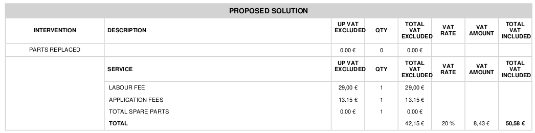

Just a detailed downbreak of costs for the unbricking of a Fairphone :five: via Cordon:
Same for FP4 unbrick:
