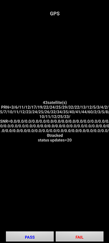

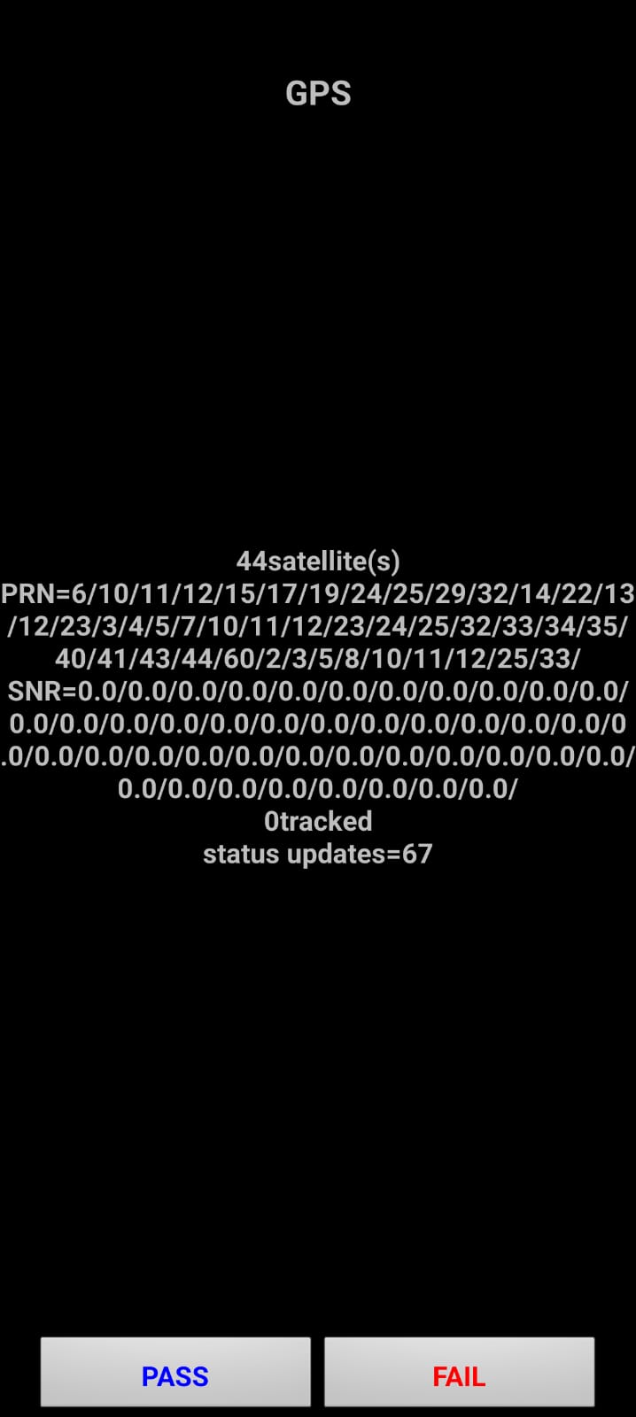

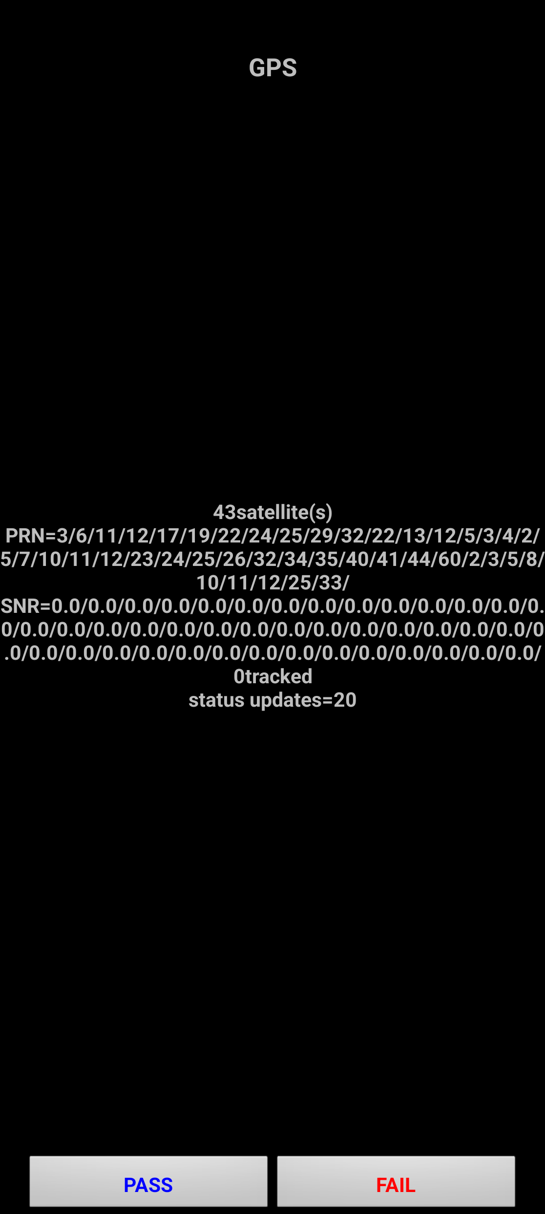

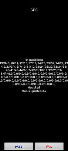

Thank you for the suggestion. I did the test. Result: 44 satelliste(s). 0 tracked.
On my FP6 (working GPS) I got this result after ~20 seconds:
I was indoors at the time of the test in central-eastern Europe.
