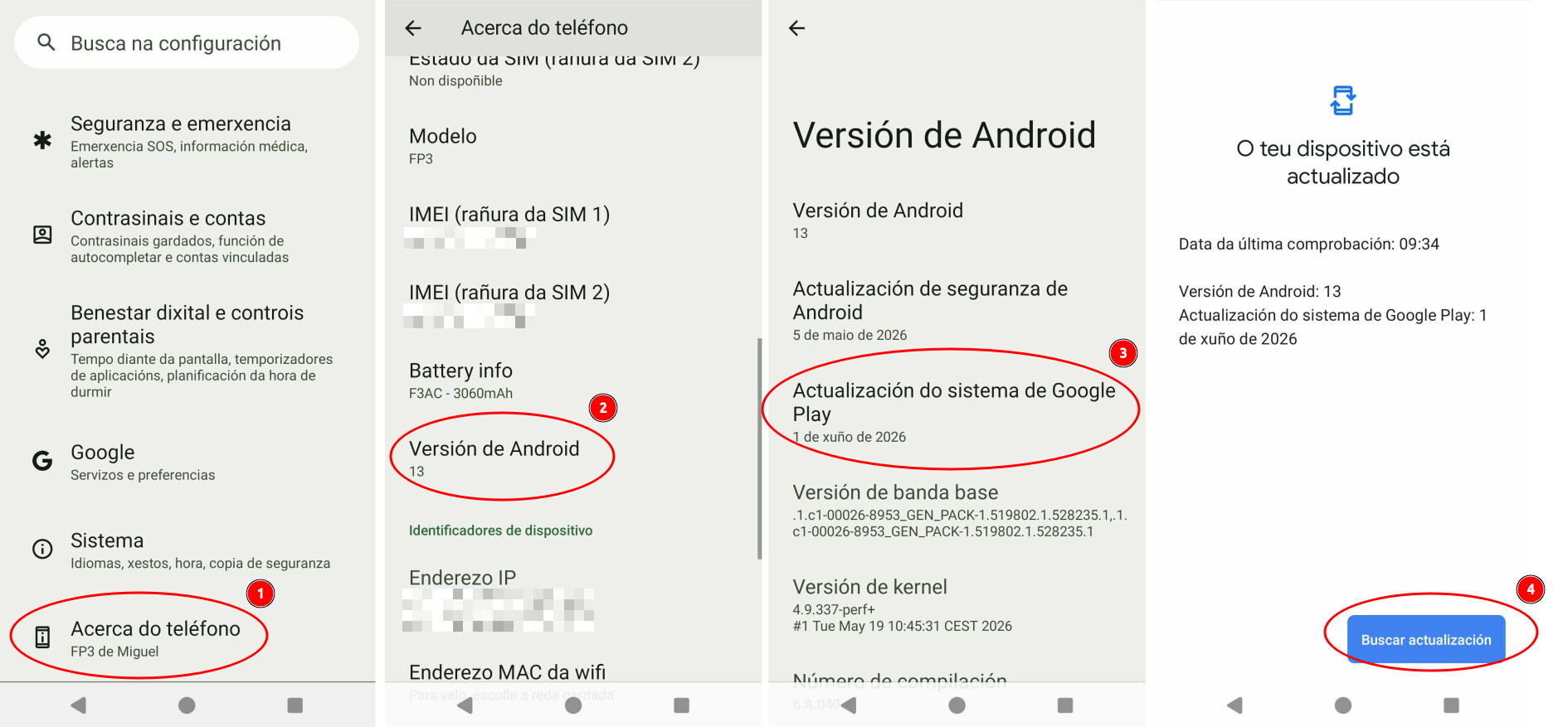

I update Google Play Services this way (FP3 defaulf OS): Settings → About phone → Android Version → Update Google Play (translation may vary)
But I’m logged into a Google account, so I don’t know it’s the same for you… :sweat_smile:

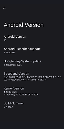

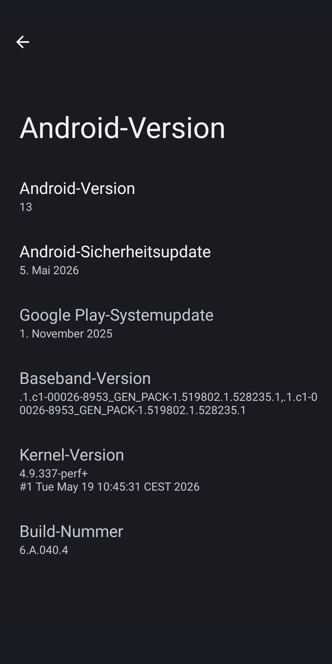

I discovered something comparing my phone with Mixigodos pics.
The google System update has the date 1° november 2025 (?!). I don’t understand this. I checked many options in my phone and still don’t understand. Any suggestions?

Your screenshot shows the rather old Google Play update from November 2025.
But did you actually follow the flow Mixidoo showed, i.e. tapping on the date and then actively searching for an update on the next screen?
Thats not working without a Google Account added. And Google Play Services is not the same as Google Play System update. Lidwiens was neither works without Google Account while using FPOS
