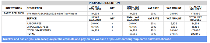

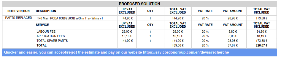

And here is the repair quote they propose: 226 euro

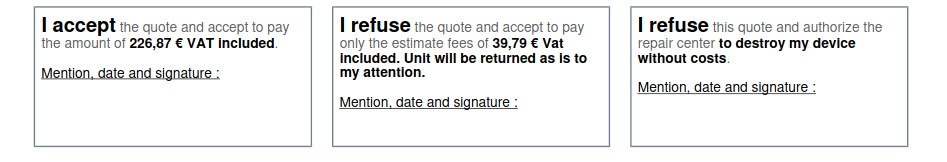

then they give me three options:
226 euros to get my phone back, because I opened it to try to see whether dissassembling some of the modules and putting them back in with special attention to the connectors could maybe save the burden to send it in for repair. I tried to save myself the hassle first of all, but also Fairphone to execute the warranty for a months old new phone.

They have identified necessary replacement of the main board (unfortunately the most expensive item of course), which could indeed have been damaged by the fall; and you stated yourself, that the phone stopped working when it fell.
So frankly, I’m inclined to think that this is just a case of bad luck.

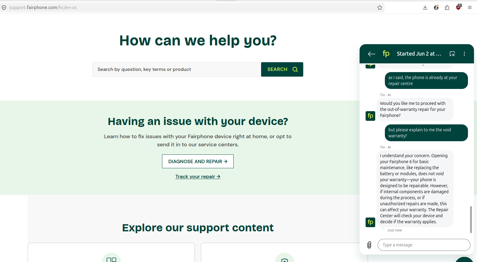

Today I have contacted the Fairphone support chatbot called Tin. Tin: “I understand your concern. Opening your Fairphone 6 for basic maintenance, like replacing the battery or modules, does not void your warranty—your phone is designed to be repairable. However, if internal components are damaged during the process, or if unauthorized repairs are made, this can affect your warranty. The Repair Center will check your device and decide if the warranty applies.”

Meanwhile, Cordon has given me the deadline to decide on June 28th or they will destroy my phone. I understand it, but that’s a time bomb.
