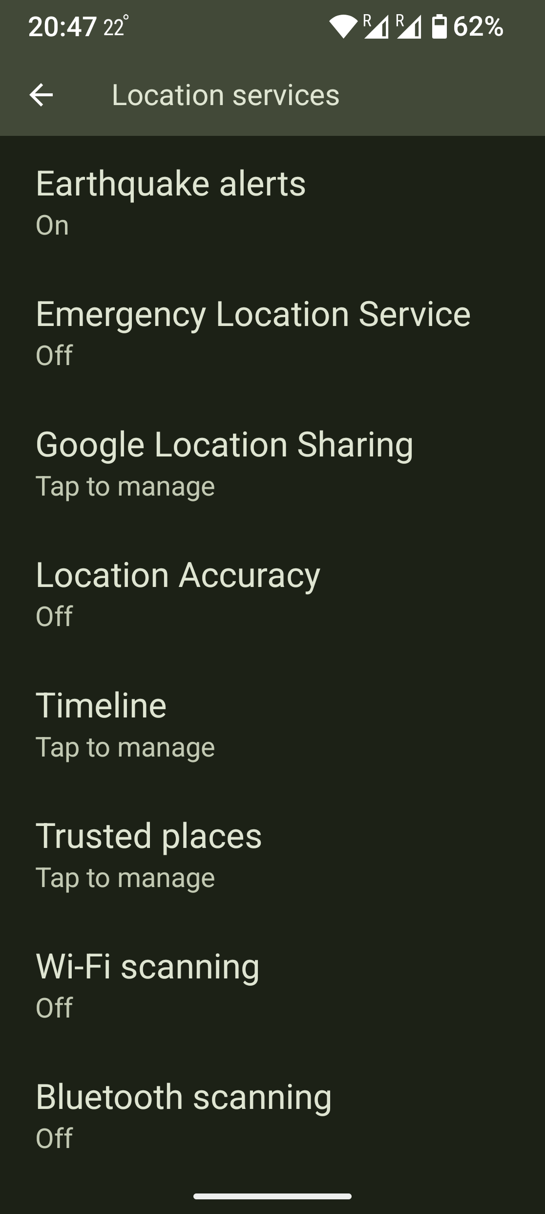

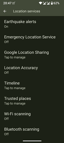

A new thing. I turned Location Services back on but switched off “Location Accuracy” in “Location Services” - basically all location heavy apps tell me that is a terrible choice, but will mostly work after they made that point (and they got a GPS lock). Bluetooth, WiFi and dual SIM are on. Current up time is 10 minutes after turning Location Accuracy on just to see what would happen after a reboot (it immediately went into a reboot). This setting can be turned off while in airplane mode for those who experience “faster” loops.

I turned off Location Accuracy and it stayed up for 9h.
Before that it was rebooting either 1-5 mins or stayed up for almost an hour.

I turned the location accuracy back on while hooked up to my laptop and so far it’s up for additional 22 mins.
Same story here (except it’s been 20 hours). I’ve since turned location services back on but turned off increased accuracy and that was 3 hours ago.
Well, I spoke to soon. I have the same issue. I just witnessed my phone reboot. I now remember having to type my pin a few times lately and realize I’ve probably been through reboots when that happens. Turned off GPS for now.
So after turning Location accuracy back on, it stayed up for about an hour and then it did 2 reboots back to back:
61:2025-10-03 09:25:23 SYSTEM_BOOT (text, 479 bytes)
62:2025-10-03 09:26:46 SYSTEM_BOOT (text, 479 bytes)
Actually I noticed there is a pattern. Once whatever this config is applied and makes the phone reboot on the next boot it’ll apply it again and reboot immediately. Then it stays up a bit longer: up to an hour sometimes and then this pattern repeats.
Btw, I’m on Rogers in Toronto area, Canada.
I noticed the same pattern as well. The 2nd reboot is immediately. Mine has been up for 14 hours with Location On and Location Accuracy Off.
