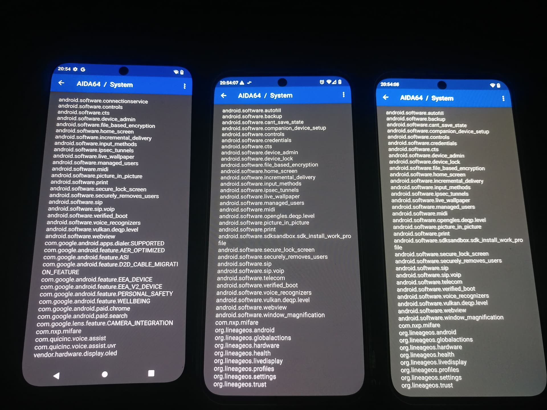

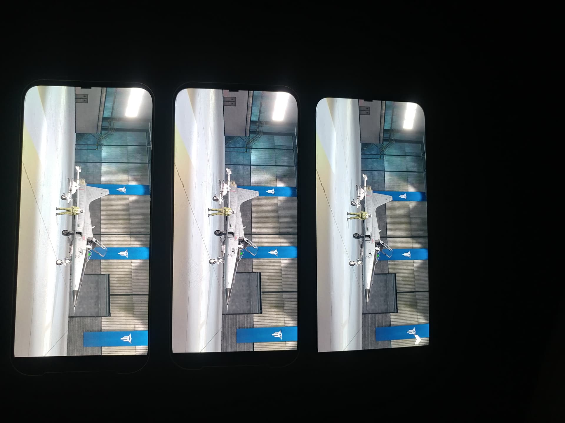

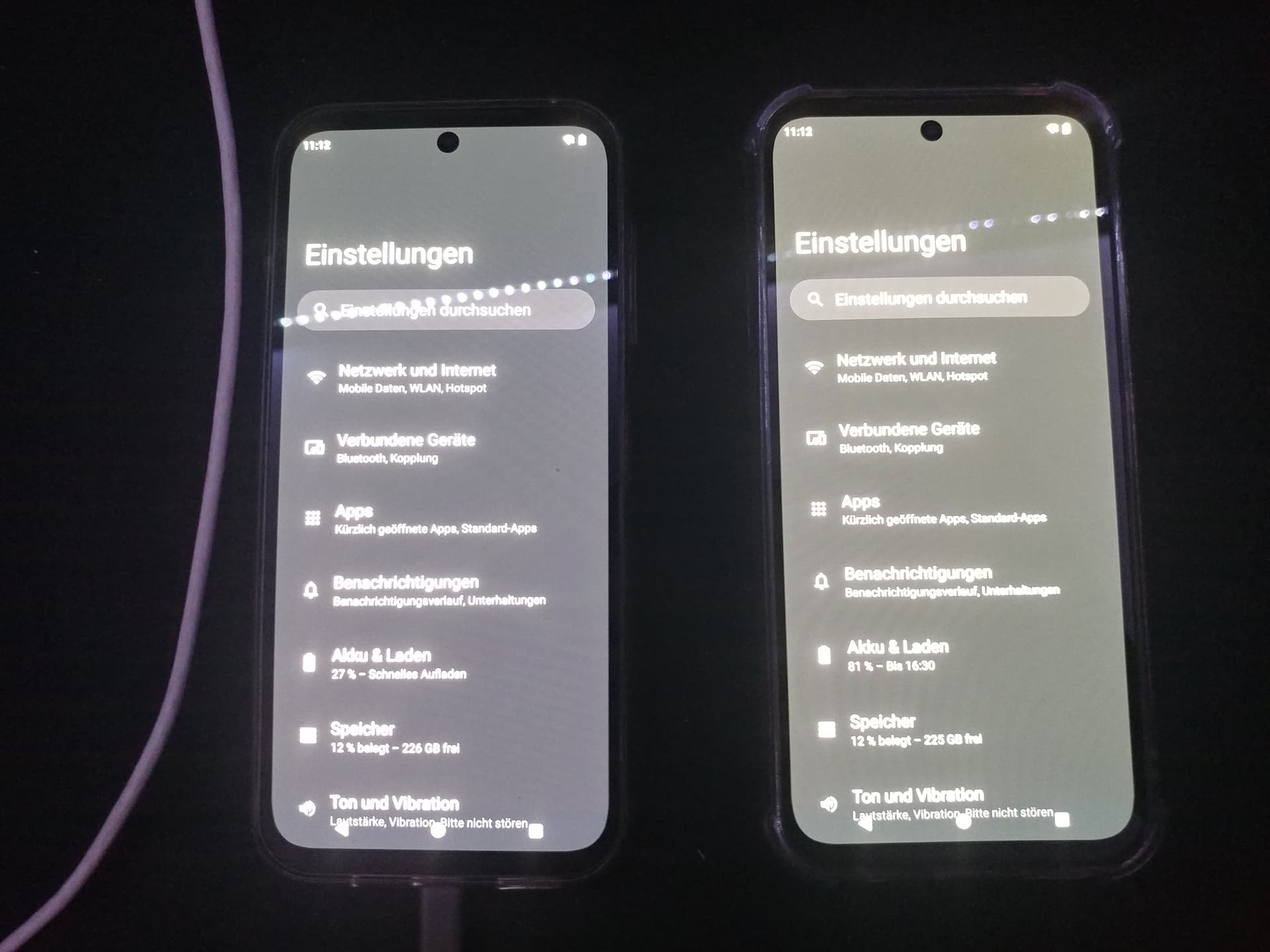

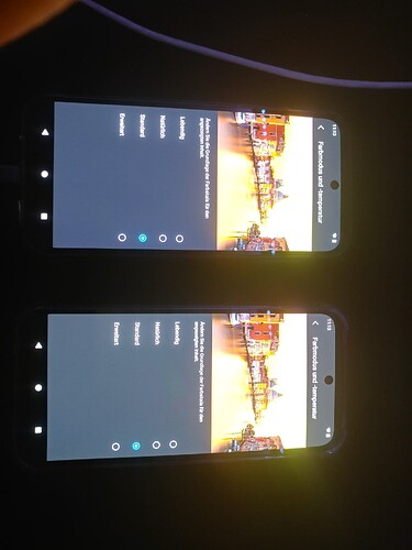

This is 100 percent a screen issue. I have 3 FP5s at my disposal and my fp5 which i bought at launch, had (i swapped it but still have the problem screen) the same issue.
The screen downright behaves like an lcd screen -not an lcd but more testing needed on the quality-, but beyond that the screen has a greenish tint (thats why i even started comparing the screens after noticing that Metal Storm looked way worse on any rom on my FP5 with worse contrast and said color shift).
On the other hand the screen can get so dark that i barly see something in a pitch and i mean pitch black room (and on extra dark it gets so grainy that i infact cant see recognize text) and at least noticeably brighter than the other two properly working screens. -Have to check by swapping screen could be os thing.-
My theory is that they for some reason shipped early models in 2023 with lcds they ordered on preproduction models befor they decided to pit an oled into the phone. But its only a theory all i have for sure are the discrepancy in quality. -Nope-
First two taken with FP5 second two with US996.
If i am right sell the lcd ones as a limited even cheaper version instead of scrapping the screen XD.-I am not right-
