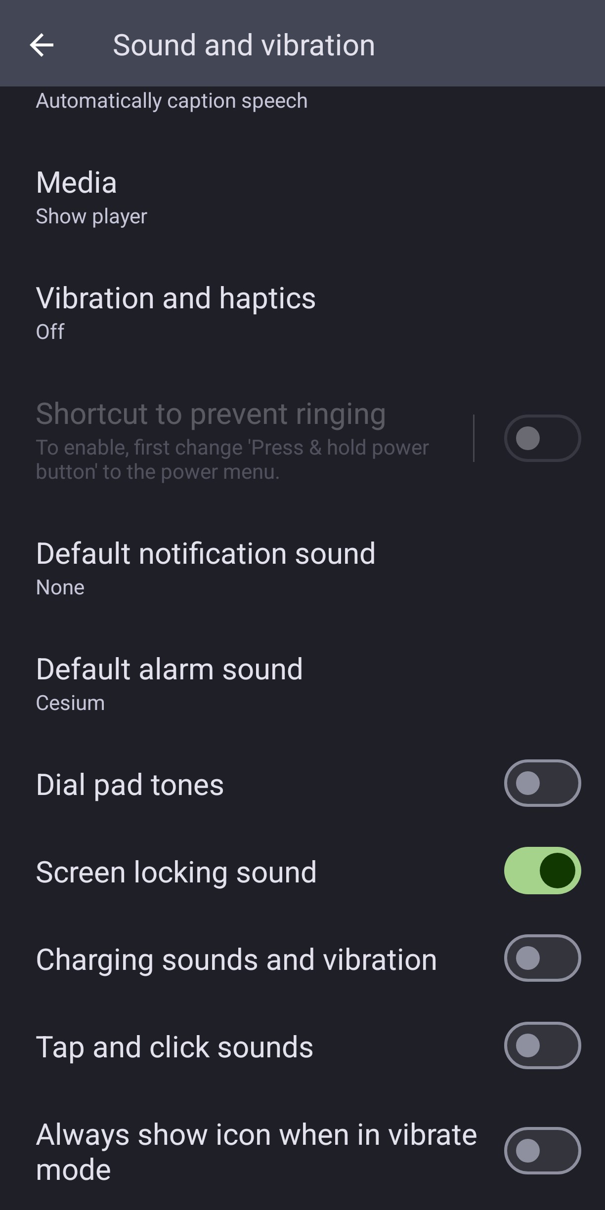

Could you please share the screenshot of your settings. This is mine and it seems to be working for me (toggling it on brings a funny soundlike thing)
Hi,

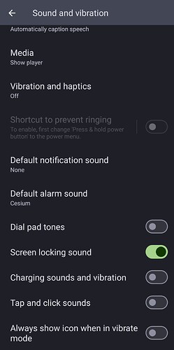

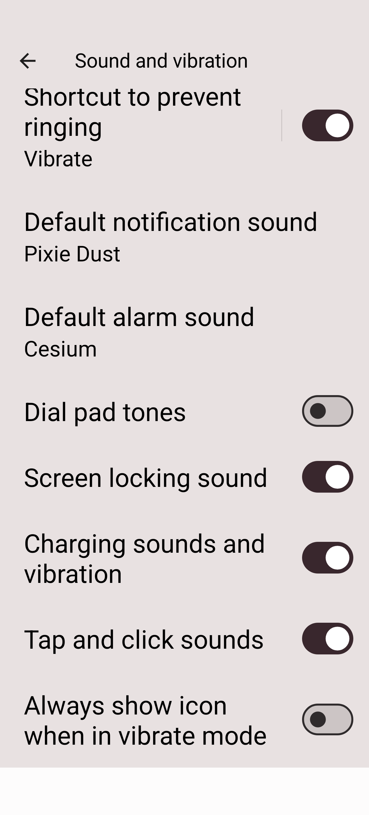

I have the following settings for Sounds. My fp5 is pretty silent with those settings

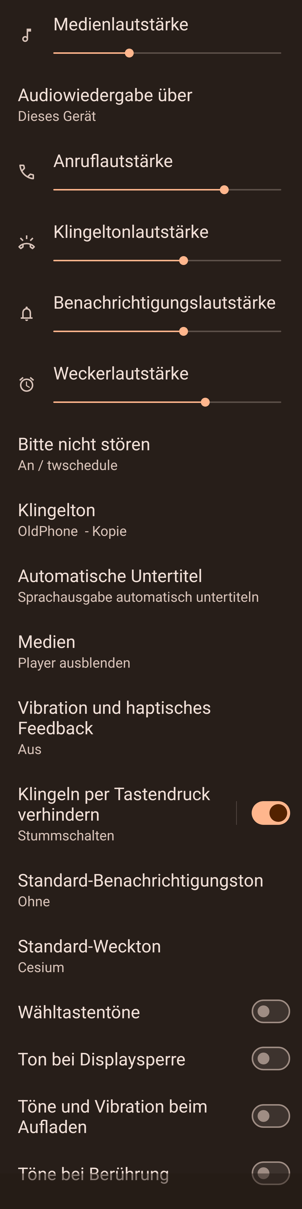

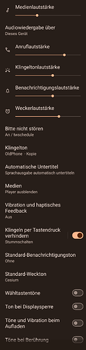

Hi Meaghan. Thanks for your attention, here it is:
Thanks. But basically these are my settings too. Especially “Wähltastentöne” off, “Töne bei Berührung” off and “Vibration und haptisches Feedback” off
Yes, my Fairphone has gone through some updates, and I have restarted it after change of the settings.

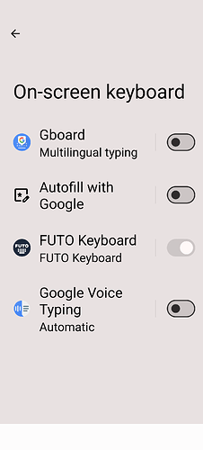

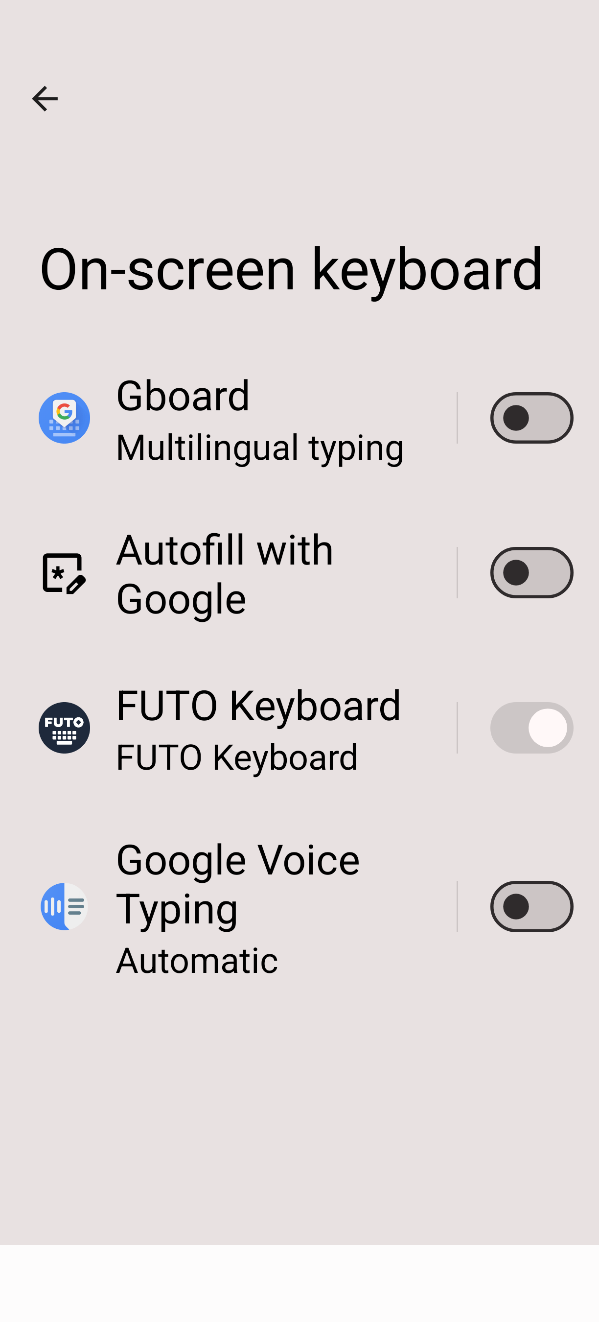

could it be some specific settings connected to keyboard? which keyboard are you using?

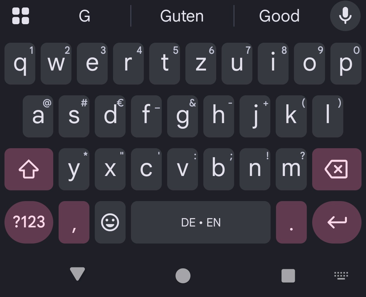

yes, maybe! I noticed, that the keyboard looked different since a couple of weeks. For example the keyboard of WhattsApp, see screenshot. There are small letters indicating the letter when the Shift-key is pushed. I did not have these small letters before, if I remember correctly. But honestly, I do not know exactly how to answer the question “which keyboard are you using”? Where can I specify this?
In settings, choose keyboard
I am now using FUTO and it did have a separate setting for a sound typing

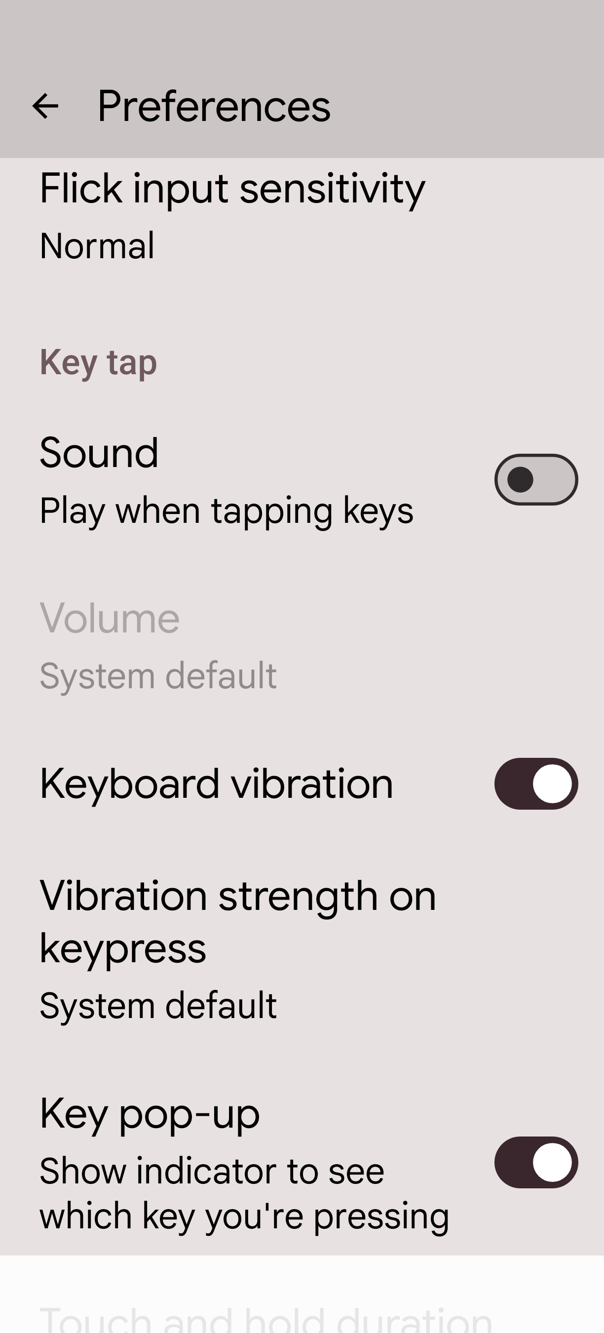

Yours look like Google board, please check settings, preferences and sound
Niels,

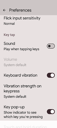

check your Keyboard settings, there is a Sound setting somewhere
Mine is switched Off
Hurray, that worked: “sound, play when tapping keys” is now off. I wonder, when I changed that.
