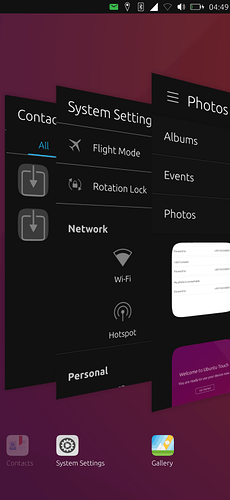

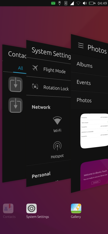

Just tried it (OTA9), found some flaws:
  1. USB access (for files and pictures) only worked after enabling dev-mode (is this intentional?).
  2. WLAN is set to US/FCC. Wasted 2hrs to fix it. “iw reg set DE” didnt work, no reg DB to be found, gave up eventually.
  3. LTE worked (40Mbit down/up), VoLTE didnt (at least no sign of “HD” on neither phone).
Wouldn’t use it as a daily driver yet (the interface is pretty different)
 but it would be possible to do so, seems already in working order: Very snappy and polished.
Thanks :heart_eyes: Looks much better than years ago. Installing was easy, might give it another shot when I figure out how to use it with my big screen.
PS: Nice surprise to see the tasks floating :face_savoring_food:
