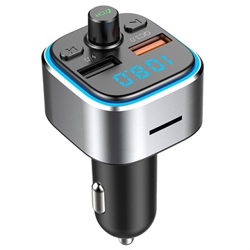

You can buy QC3 chargers for a car type 12v supply
I bought one of these ages ago and it works fine charging my Fairphone 4 from a vehicle 12V cigarette lighter socket. And it has two USB ports on it!
