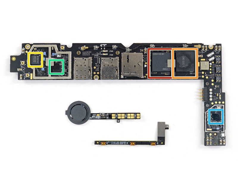

The Fairphone 3 sports a capacitive fingerprint scanner as can be seen on this picture (the middle loose component):
I am not sure which exact model it is.
It (that is, the hashes based on the input data of your fingerprint) should be stored in the secure element of the ARM processor. This storage is done locally, not in the cloud. If it is, that is huge a security risk and design flaw. We know it is stored locally only though because the data is not available during an Android backup migration.
