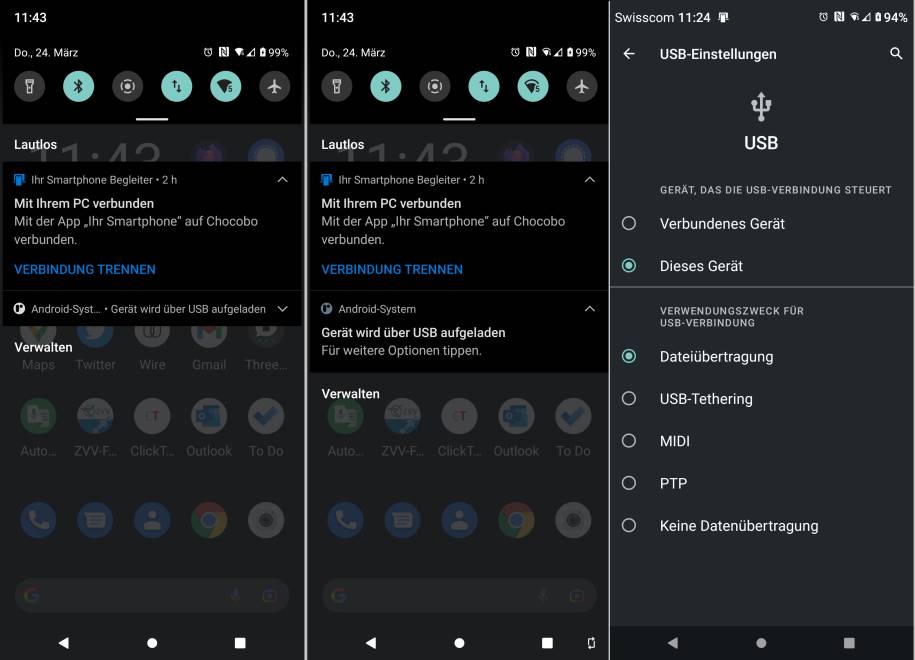

That’s what it should look like.
If you don’t see the “Android-System Gerät wird über USB aufgeladen” (I’m using German language), I could imagine two things
  • if you have many active notifications (like I usually do) the option is outside the visible screen area and you need to scroll down first (it is always the last notification)
  • I’m pretty sure there were reports by people who had USB cables that worked with other phones but not their Fairphone; so you might try with a different cable if you have one or try with a different USB port on the computer
Other than that: developer options are not necessary for a data connections. One can use those to autoselect the connection mode as a convenience feature (if you want to take the security risk that potentially means).
