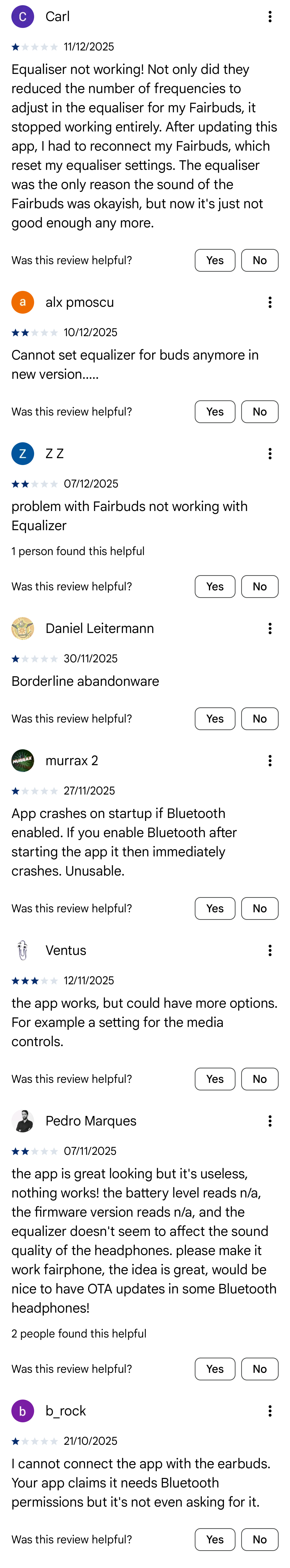

Hi, I don’t use Fairbuds so I cannot really verify but looking at the reviews in the Play Store, it seems you are not the only one.
Surprisingly I can only access those reviews on my phone, the web browser version limits me to Polish ones (?), but here there is a peek.
I included the older ones (prior to the update as some also mentioned issues with the equalizer)

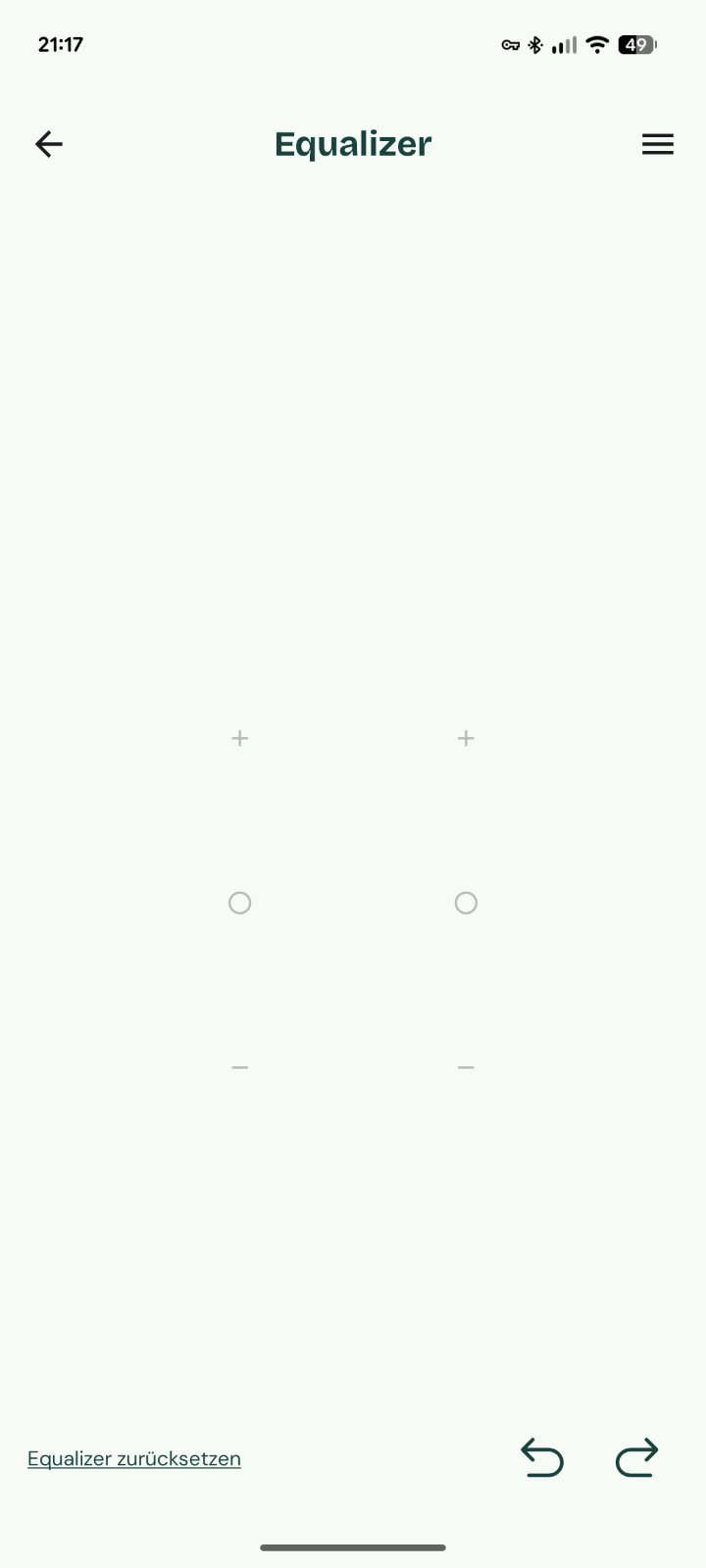

There was now an update of the App to Version 3.4 - but it looks like it got even worse.
The equalizer does not even load most of the time:
But if it loads, it still does not work; The app seems to do nothing; battery levels are not shown, and so on… :frowning:
