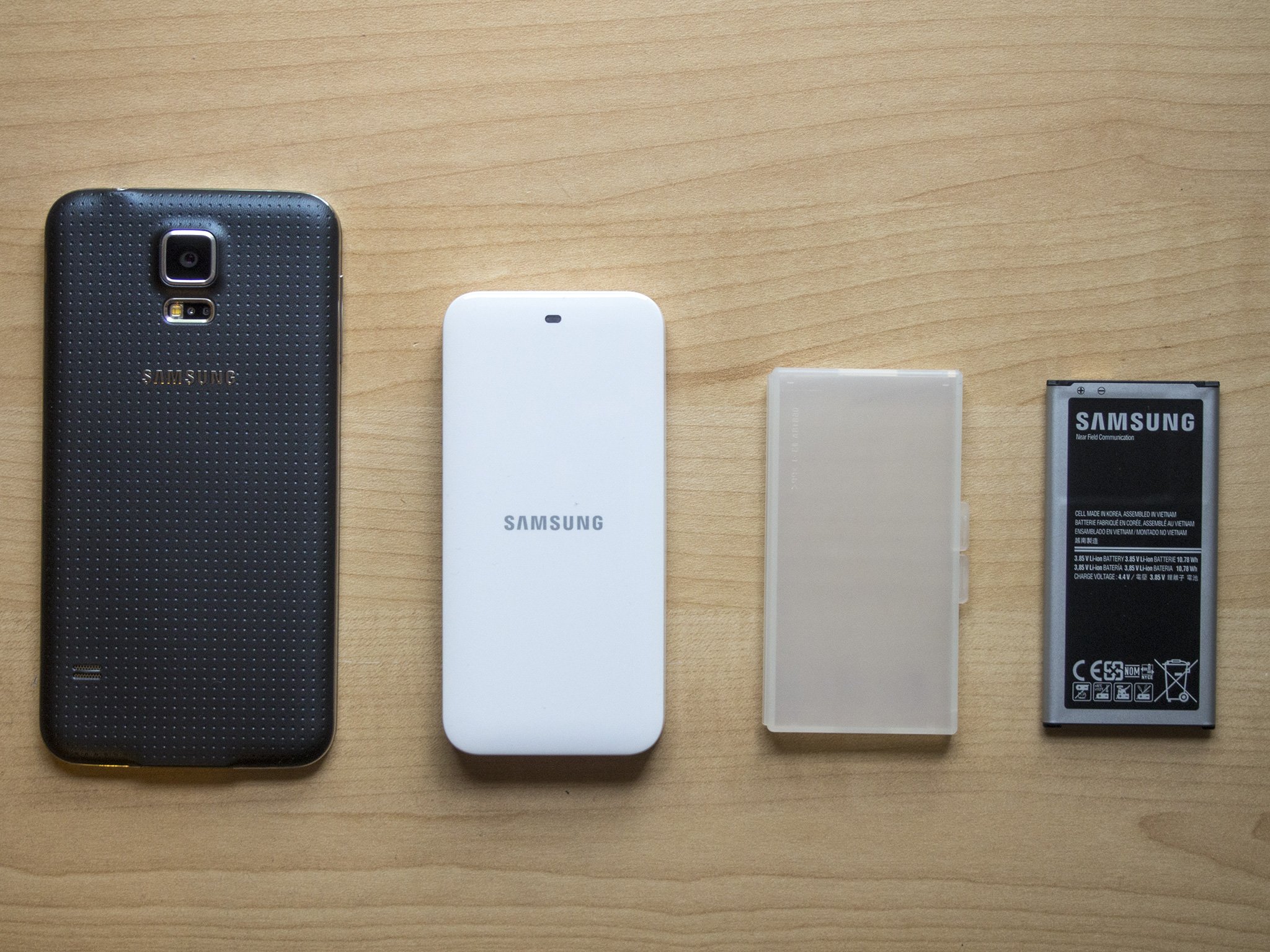

Actually, Samsung, in days gone, sold replacement batteries in a small nice piece of plastic cover with an external USB connector, which doubled as a charging cradle.
So you had a nice cover to carry around your second/third battery in your pocket. You effectively could charge it away from home when visiting by connecting it to a basic USB charger. No dirt could get into the contacts or cause a short by mistake.
