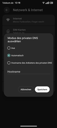

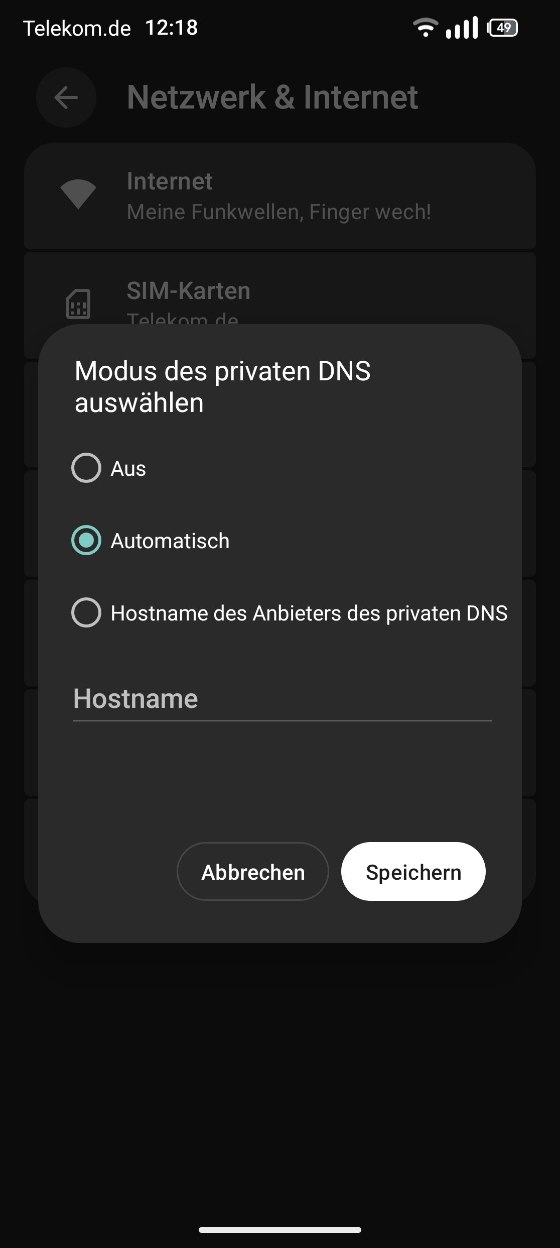

While reading the posts about DNS I thought to check my settings.
For me the solution seems to be setting the ‘Private DNS’ to ‘Automatic’.
Not a clue why that seems to work. But before changing the setting, it was on ‘disabled’. And for me the solution to hanging apps was also disabling WiFi.

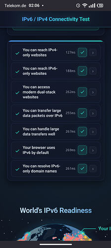

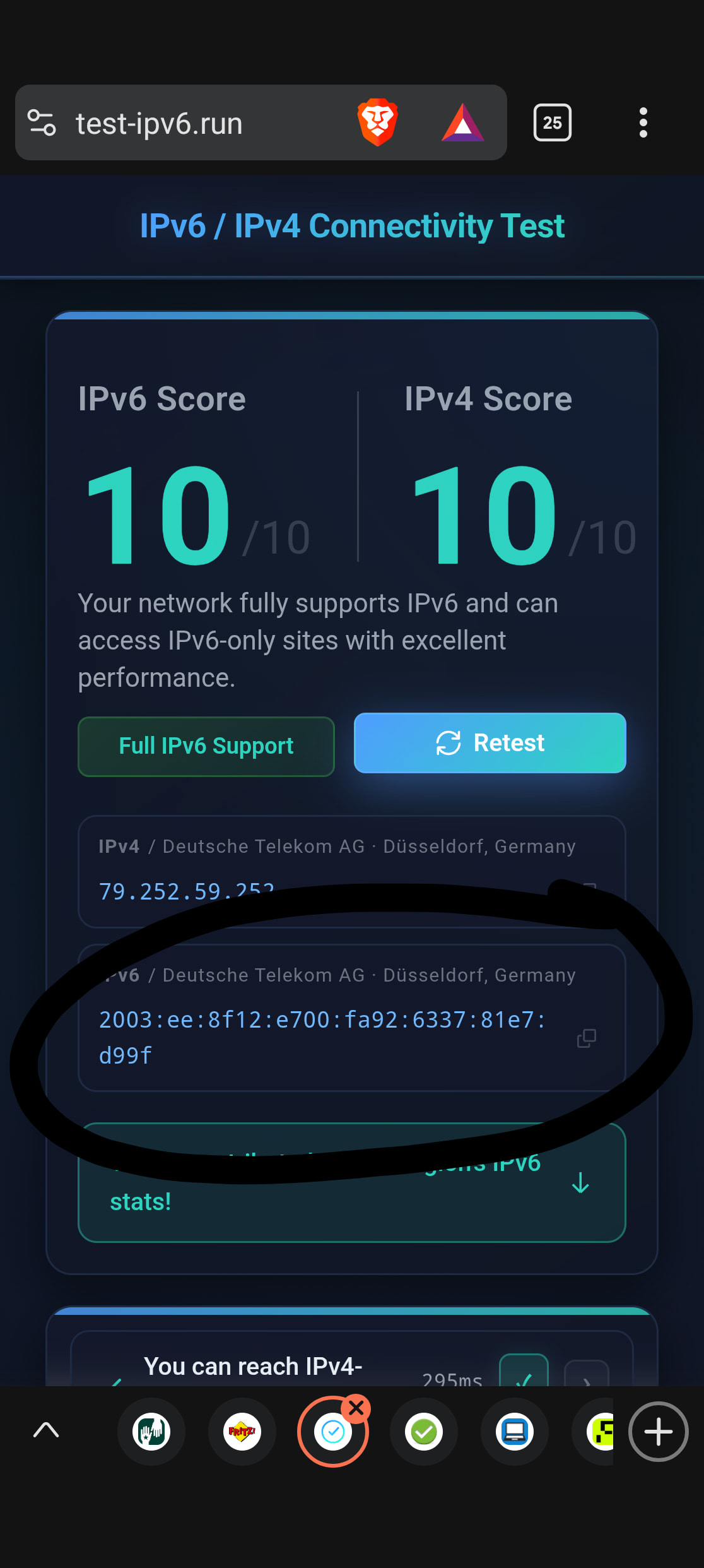

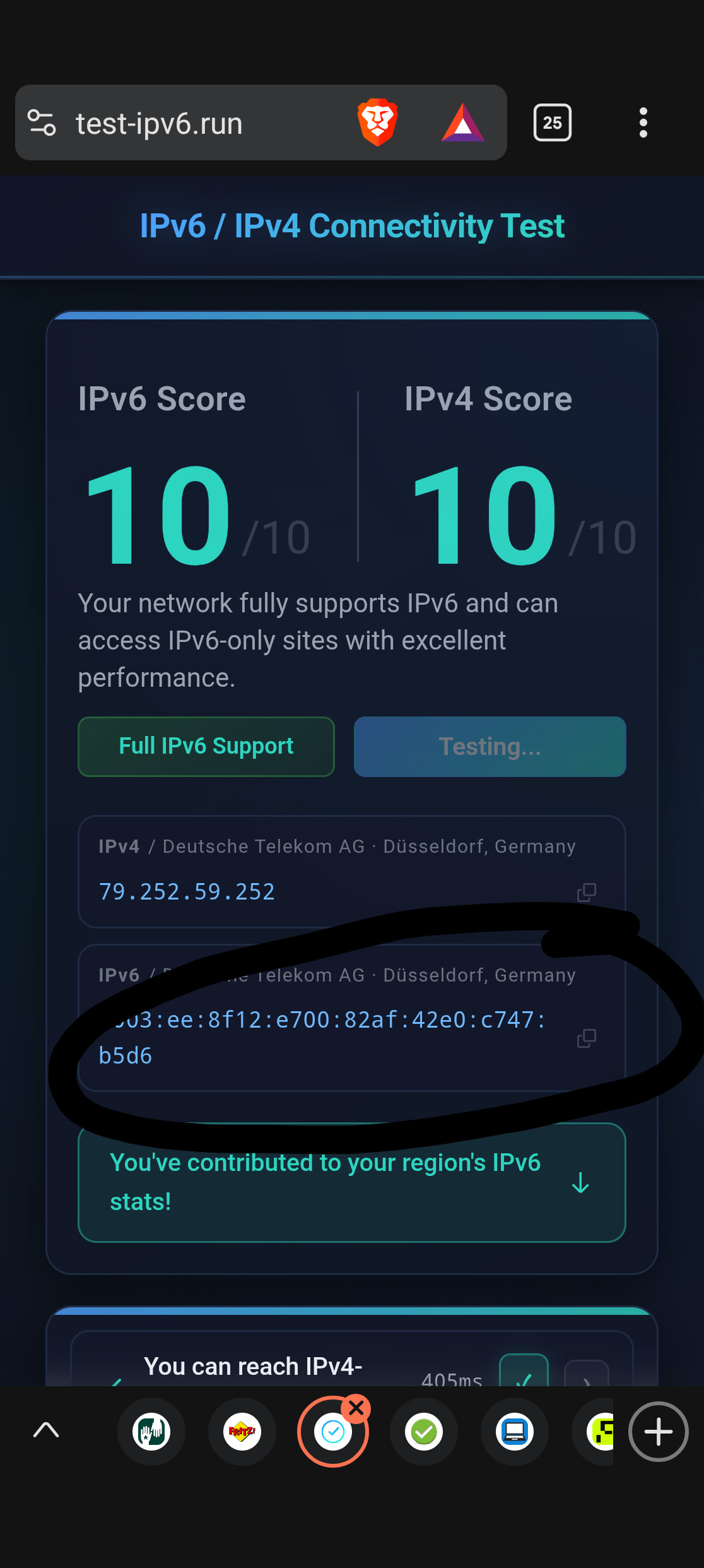

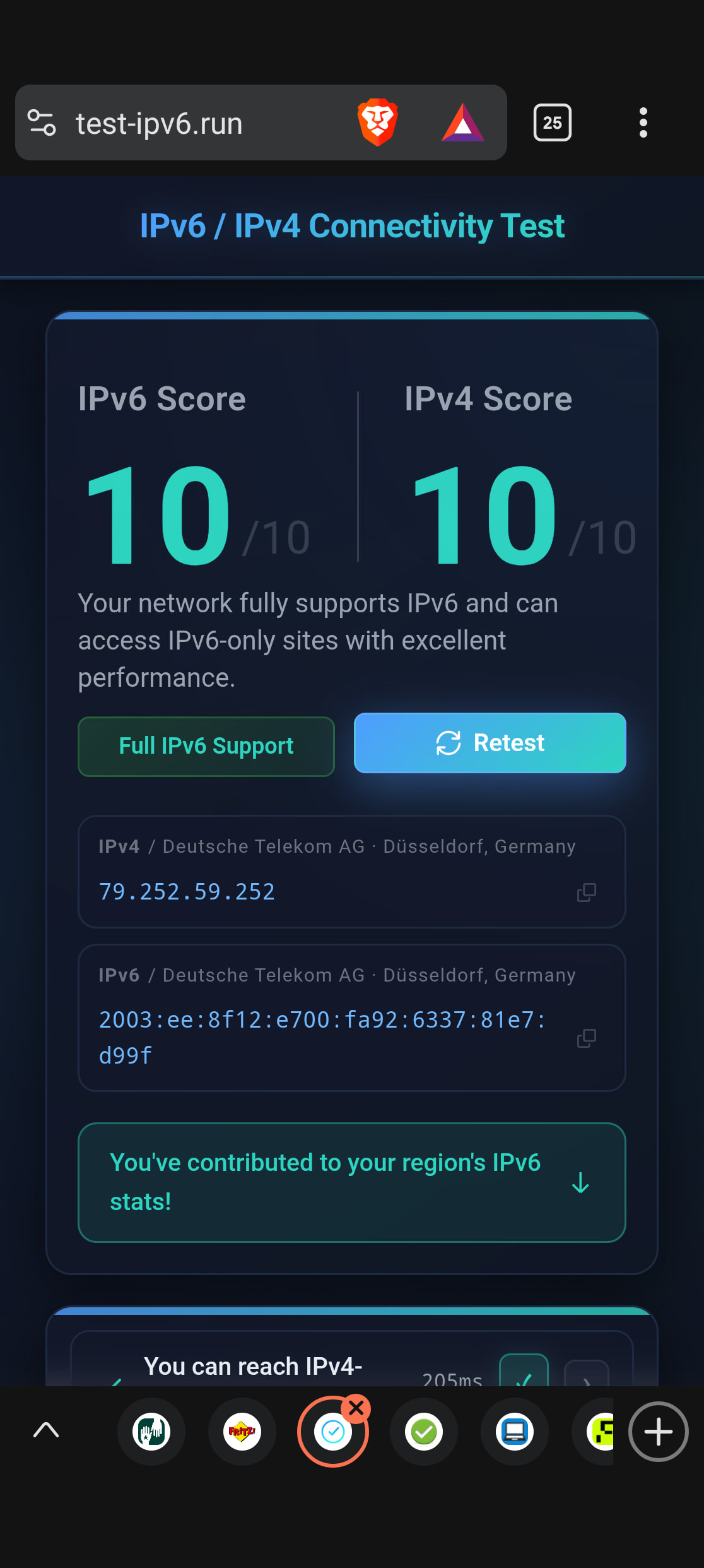

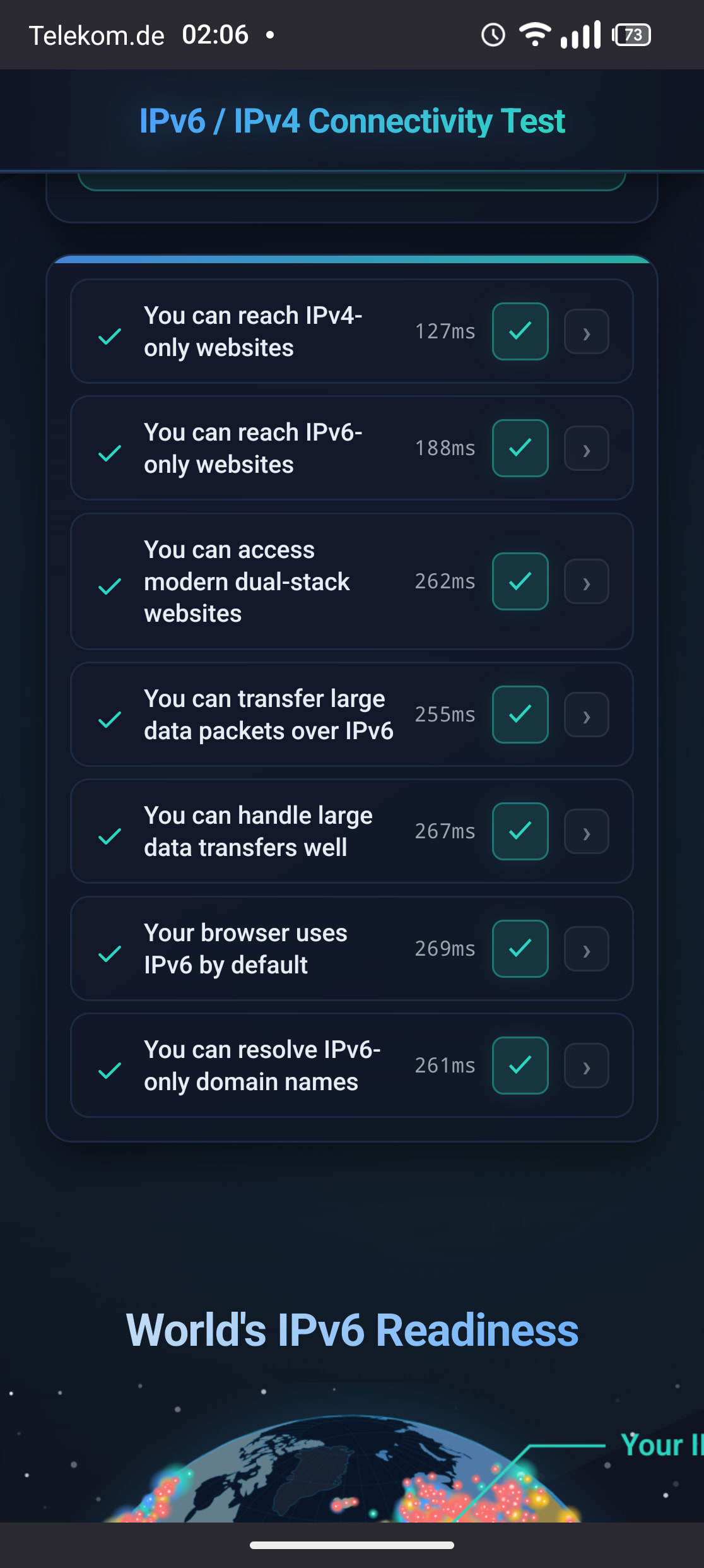

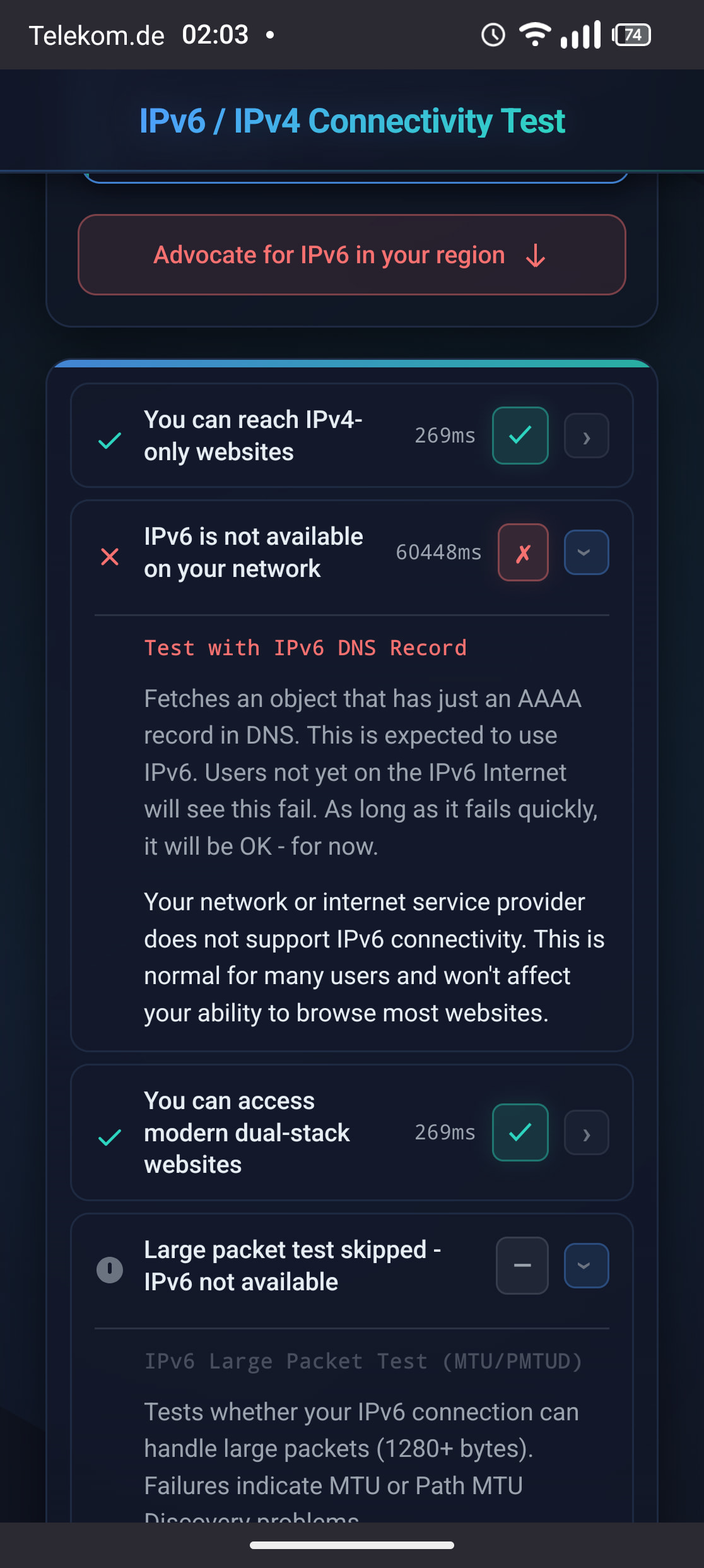

By checking https://test-ipv6.run/ the result is
When toggling WiFi off, waiting about 10 Sec and turning off, the test also passes for IPv6 DNS
Don’t ask why, but this points very strong right to Android 16 in correlation to IPv6/DNSv6. And this is only in WiFi.
I have the exact same results on my FP6 with Android 16.

For clearification:
My default setup was already “automatic” so the workaround to change it to that doesn’t work for me:

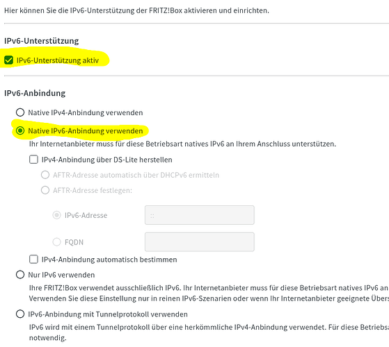

I had similar issues since android 16 and only in my home-wifi. I solved it by still using ipv6.
i operate a fritzbox 5690pro. Previously the default option “use native IPv4 connection” was set. I changed it to the second option “use native IPv6 connection”.
here my new configuration. sorry, german:
best regards

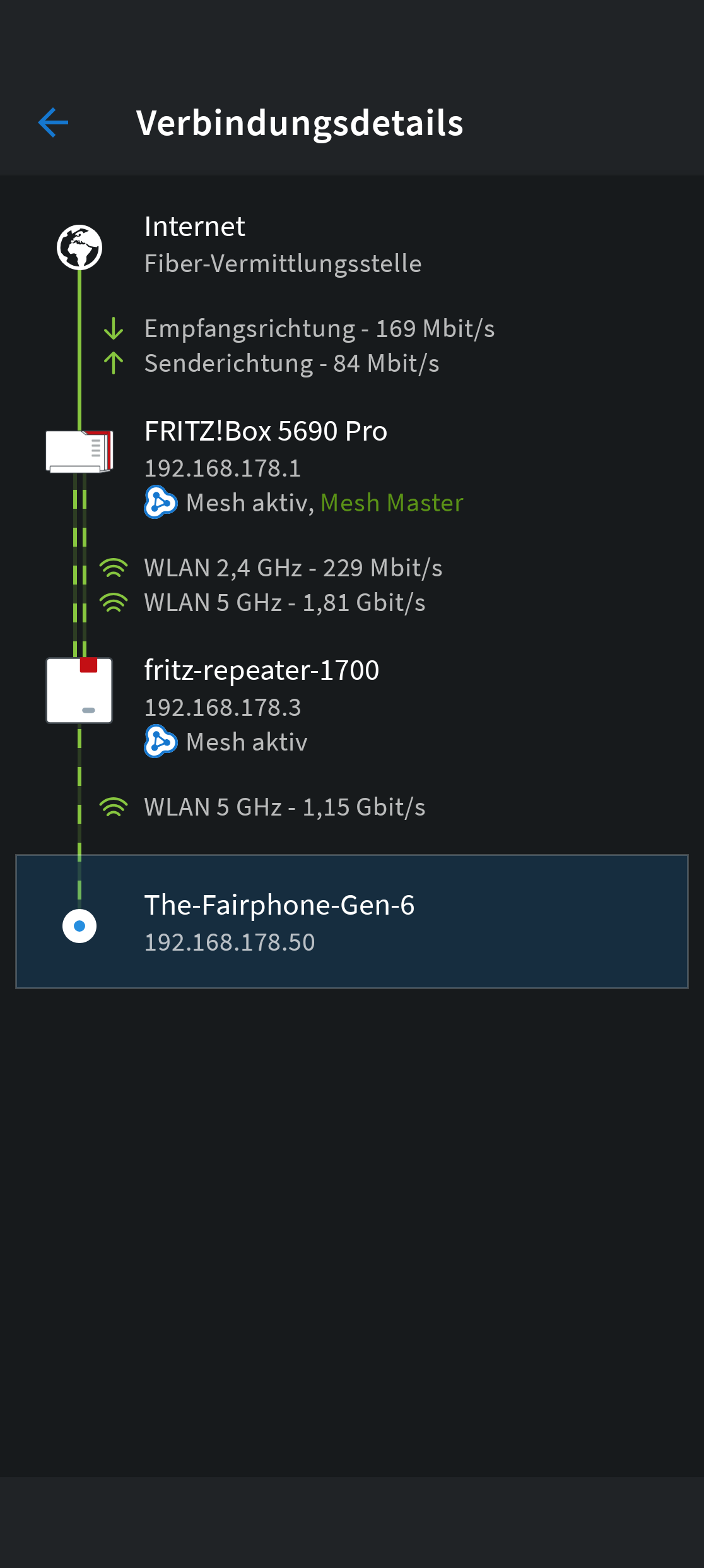

After trying a lot (moving my router and repeater to the latest lab versions of the OS, changing the repeater to an old model with WiFi-5) and achieving nothing but making things even worse I decided to give up and make a clean install.
So I reverted the router (FRITZ!Box 5690 Pro, placed at the entrance of my flat) to the latest stable version of the OS, which forced a factory reset. I then set up everything from scratch (esp. giving my devices fixed addresses). Settings were kept as close as possible to the AVM setup (using the router as DHCP server and DNS resolver, only widening the range of the home network, not splitting the WLAN). My FRITZ! Repeater 1700 (placed at the entrance of my living room, serving as WLAN/LAN Bridge) is still on the latest lab OS.
After some reboots and purging of the WLAN entries of the FP6 and cleaning data and cache of “MyFritz! app” and “FRITZ!App WLAN” everything was up and running.
The results so far:
(1) FP6 in my living room connected to the repeater:
(2) After shopping, FP6 in my living room connected to the repeater, no manual WLAN reset!
Fingers crossed…

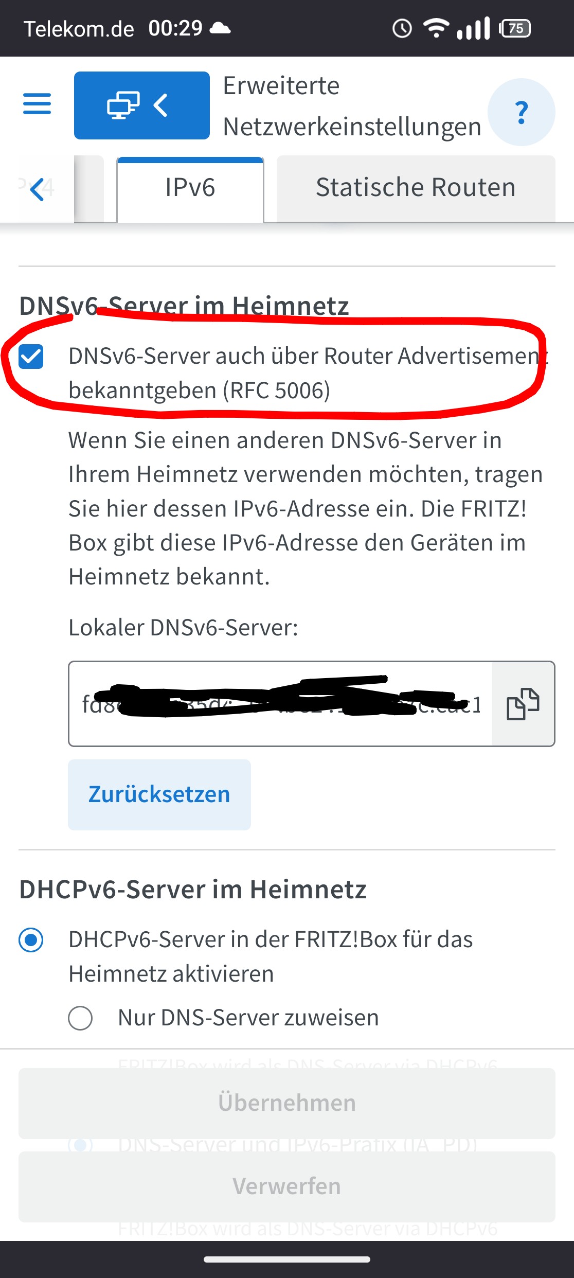

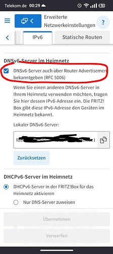

On the router (FRITZ!Box):
Home Network → Network → Network Settings → IPv6
Disable the following option:
“Announce DNSv6 server via Router Advertisement (RFC 5006)”

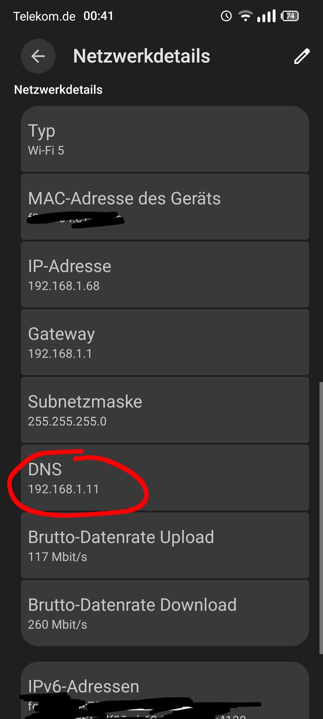

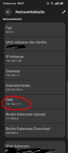

Go to Wi-Fi → your network → details
Look at the DNS field
Before:
IPv6 DNS present (e.g. fdxx:…)
plus IPv4 DNS
After:
Only IPv4 DNS remains
no IPv6 DNS entry
If the IPv6 DNS entry disappears after reconnecting Wi-Fi, the change was applied correctly.

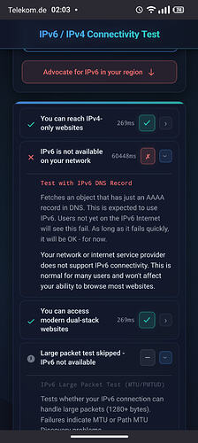

Disabling IPv6 DNS advertisement (RDNSS) on the FRITZ!Box did not fully resolve the issue for me. After some time, apps still stop loading on Wi-Fi
I still need to toggle Wi-Fi (disconnect/reconnect) to recover. So the underlying problem is still there
What changed:
DNS is now only via IPv4 (no IPv6 DNS anymore). This seems to avoid immediate DNS timeouts. But it does not fix the general IPv6 instability
Observation:
Right after Wi-Fi reconnect → IPv6 works fine (10/10 on test-ipv6.com)
After a while → IPv6 degrades or breaks again
Behavior matches what others described
So this looks more like a routing / IPv6 recovery issue rather than just DNS.
