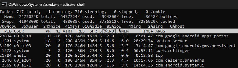

If you want to properly monitor cpu usage you should use the the android debug bridge (adb, included in the platform tools available here https://developer.android.com/tools/releases/platform-tools) and not some app. It allows you to open a direct shell on your phone and run various commands, such as the linux command top which allows you to precisely monitor resource usage. It will look like this (I opened the photos app and then took the screenshot, hence the high cpu usage in the corresponding column. The top command is also listed there for example, because it’s also a process currently running on the phone):
Of course not everything will mean something to you, so focus on the name on the right and the cpu column.
Step by step:
  1. Enable USB debugging on your phone in the developer options and connect your phone to your PC
  2. Download the platform tools from the link above and extract the zip file somewhere
  3. Open a command line window where the adb.exe file is located (in the extracted folder)
  4. Type adb.exe shell in the command line window and hit enter
  5. If you get an error message: look at your phone and press confirm/accept or whatever (there will be a popup)
  6. Run adb.exe shell again
  7. Type top and press enter and look at results
  8. Close command window and disable USB debugging on your phone again
