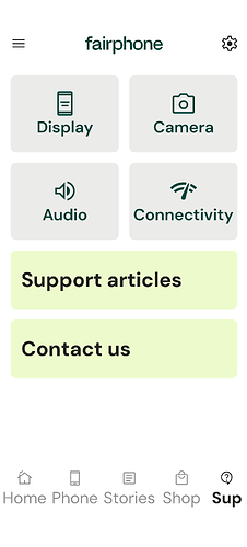

If I try to use the My Fairphone app (which the AI has ONLY JUST told me about after 2 hours!) the app has exactly the same issues as the online portal- it reset into Dutch. And most of it does not work, plus it displays badly and I cannot access parts of the screens to get it to move forward.
As before Fairphone this is your site/app for your phone using Android and Google/ Chrome which is the Android browser- everything is up to date.
As I speak German (close to Dutch) I was able to get far enough into the app to test the hardware- the phone has a problem in the secondary microphone, it looks like, and if I hit “fail” the app tries to start some kind of support process but then fails- either it displays badly and in Dutch, or it just stops working- currently it has greyed out the cookies selection popup so I am stuck for about the 10th time.

PS if anyone would like to see how far I got in the My Fairphone app, it opens a support ticket screen with “diagnose the problem” in Ducth for some reason despite my language setting being english, then hangs if I tap diagnose because I cannot do anything in this screen:
To be honest it is ALSO hard to get the app portal to work because it does not respond to short taps and if you take too long the copy and paste menu pops up! I’ve also had some kind of Gemini thing switch on which blocked a bunch of screen icons and could not get rid of until I turned the phone off then on again, so there seem to be issues in the FP6 version of Android design too.

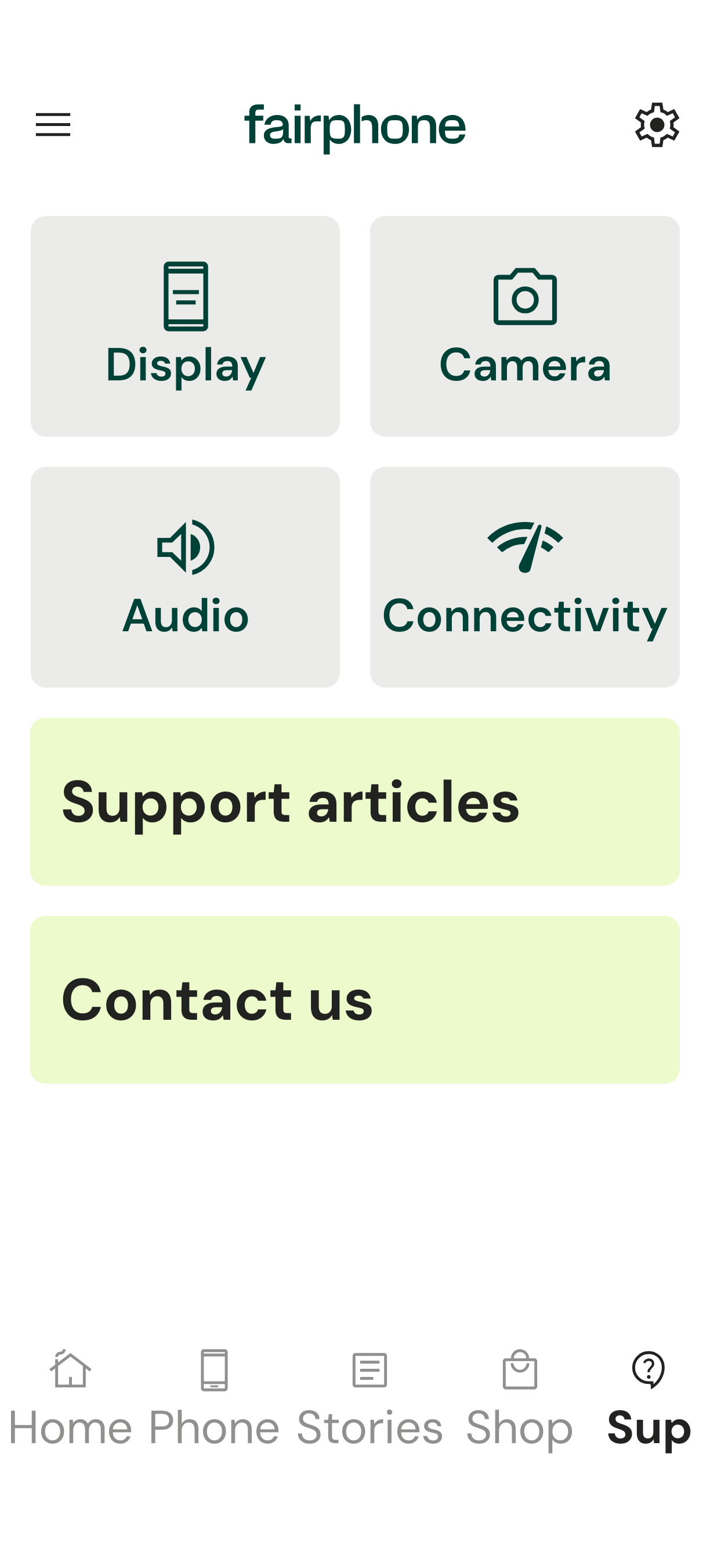

Personally I would never use MyFairphone App for self-repair portal. But I would use it for internal testing (see the screenshot below)
. I cannot say what AI (TIN assistant) meant here.
If indeed your microphone is failing, I would assume you would need to send your phone for repair. In that scenario, please back up everything you have and prepare for up to two weeks without your phone.

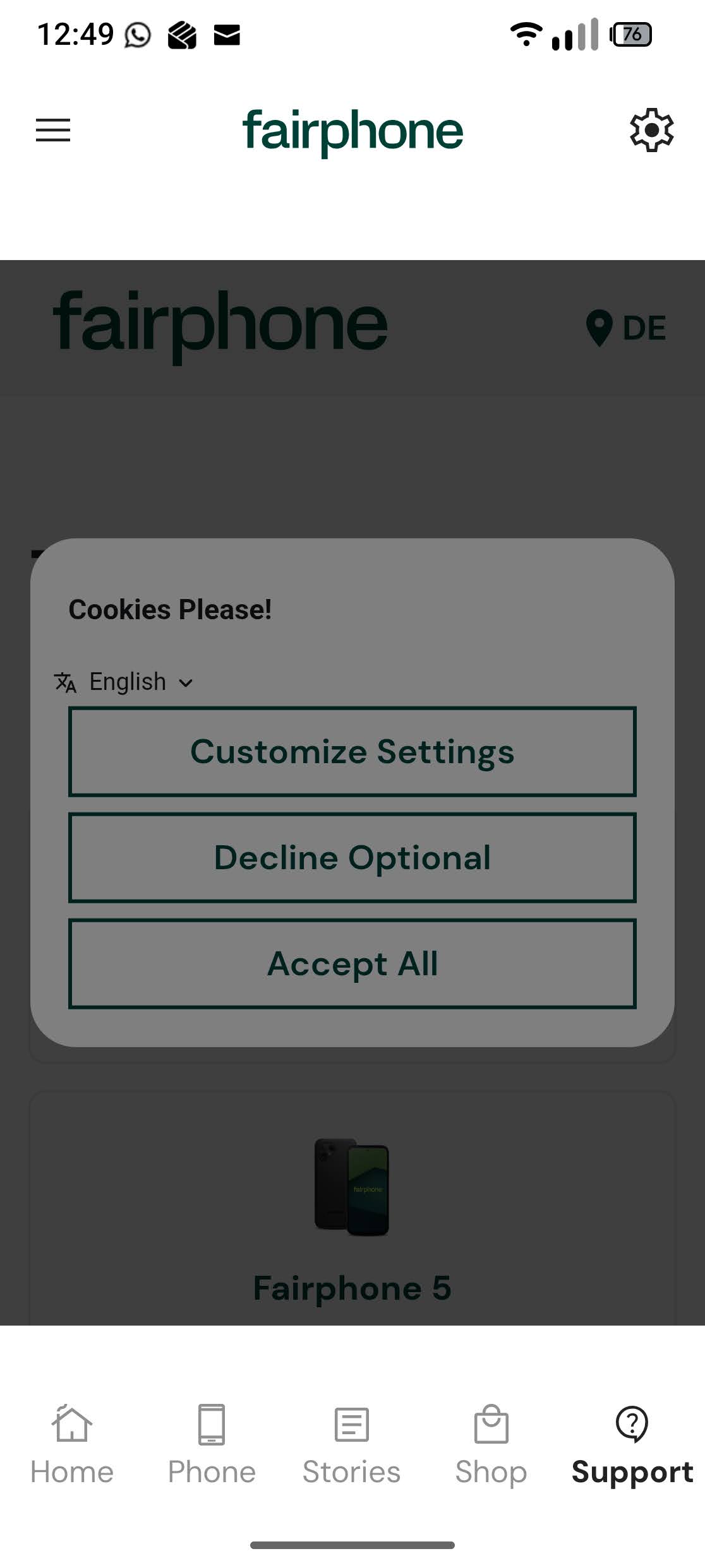

I had the same experience with the cookie settings in teh app
