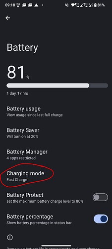

Have you tried switching to ‘slow charge’ when charging with the charger? Perhaps that will help narrow down the fault. Have you cleaned the USB-port?
hi there, I would have no idea how to switch between fast and slow charging, but all options that I use seem to be slow charging (it’s what my phone is telling me). But in the wall the phone bleeps when attached to the usb and it says that it’s charging (slowly) but it doesn’t. Though I’ve now found a plug that actually does charge, only extremely slow.

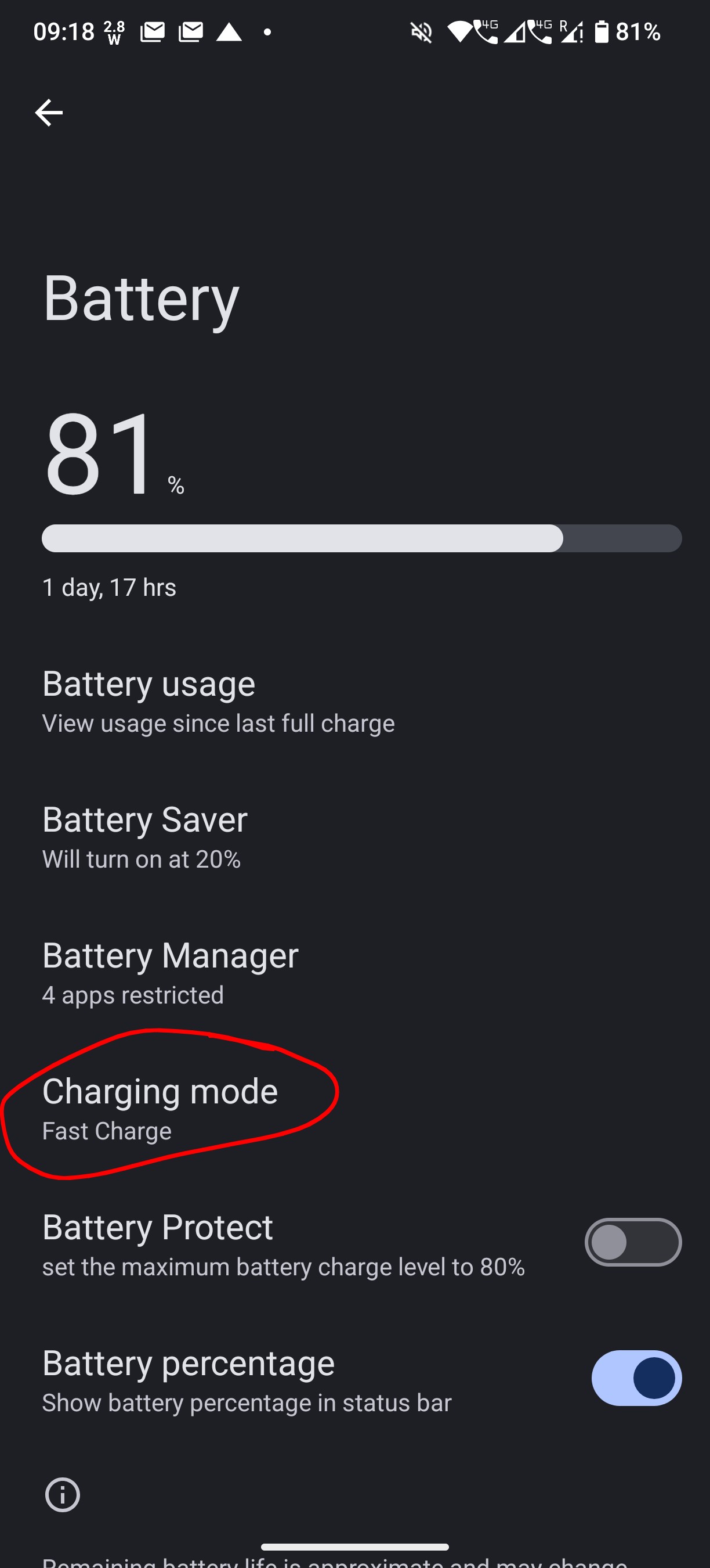

It’s here. Under “battery”.
And then there might be some dirt in the USB port. A mini interdental brush, for example, works well for this. A bit of electronics cleaner or alcohol can sometimes work wonders.
I’ve taken the usb port out, checked for any form of dirt (none) and put it back in. Made no difference. I’m careful not to poke around in it as I’m a bit clumsy… Anyway thanks for the battery charging mode, I’ve changed it to the ecosetting.
