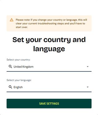

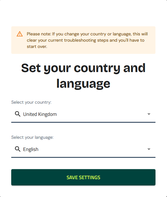

Unfortunately I couldn’t contact the official support yet because the language always gets changed to dutch whenever I try and I can’t turn it back. I don’t speak Dutch.

From your account, I’d say that you should indeed contact support. Have you been using this page? And in particular,
You should see a language confirmation dialogue
Make sure that you enable cookies.
You might want to check the language configuration of your browser.
