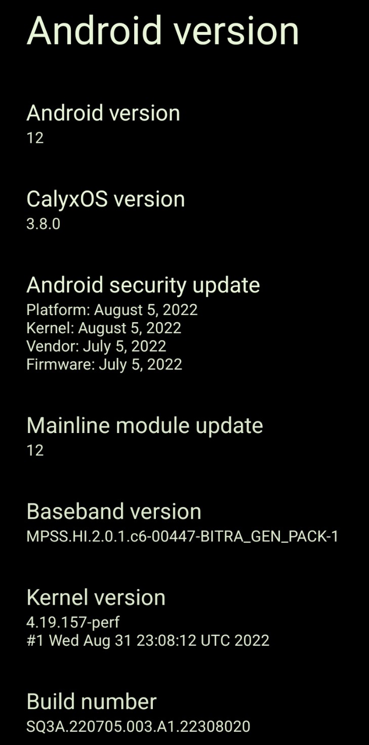

Version Details:
The L behind 12 is not shown, but I assume this is the case for all of you.
