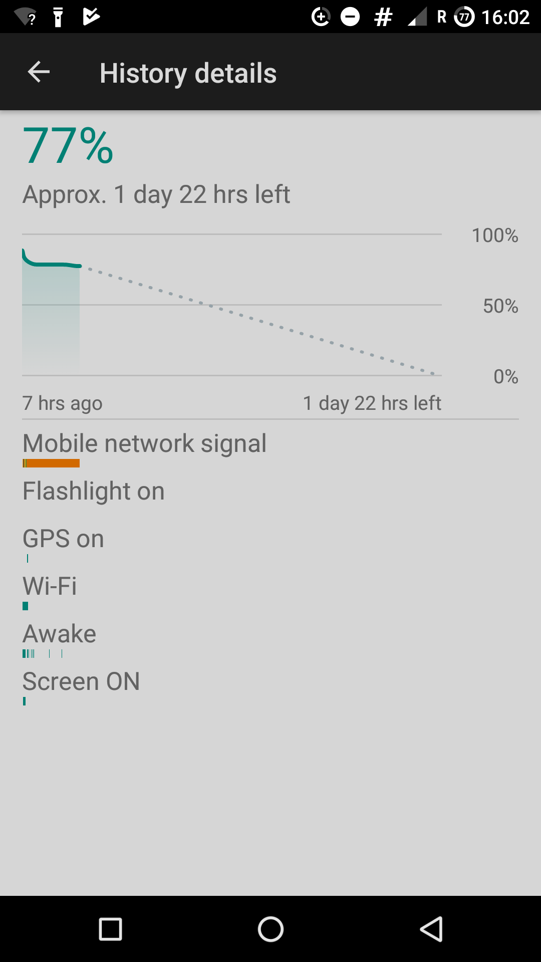

After some more observation, I have the impression, that battery drains quickly when “mobile network signal” is yellow, orange or red… could this be a reason (btw. what do the colours mean?)?

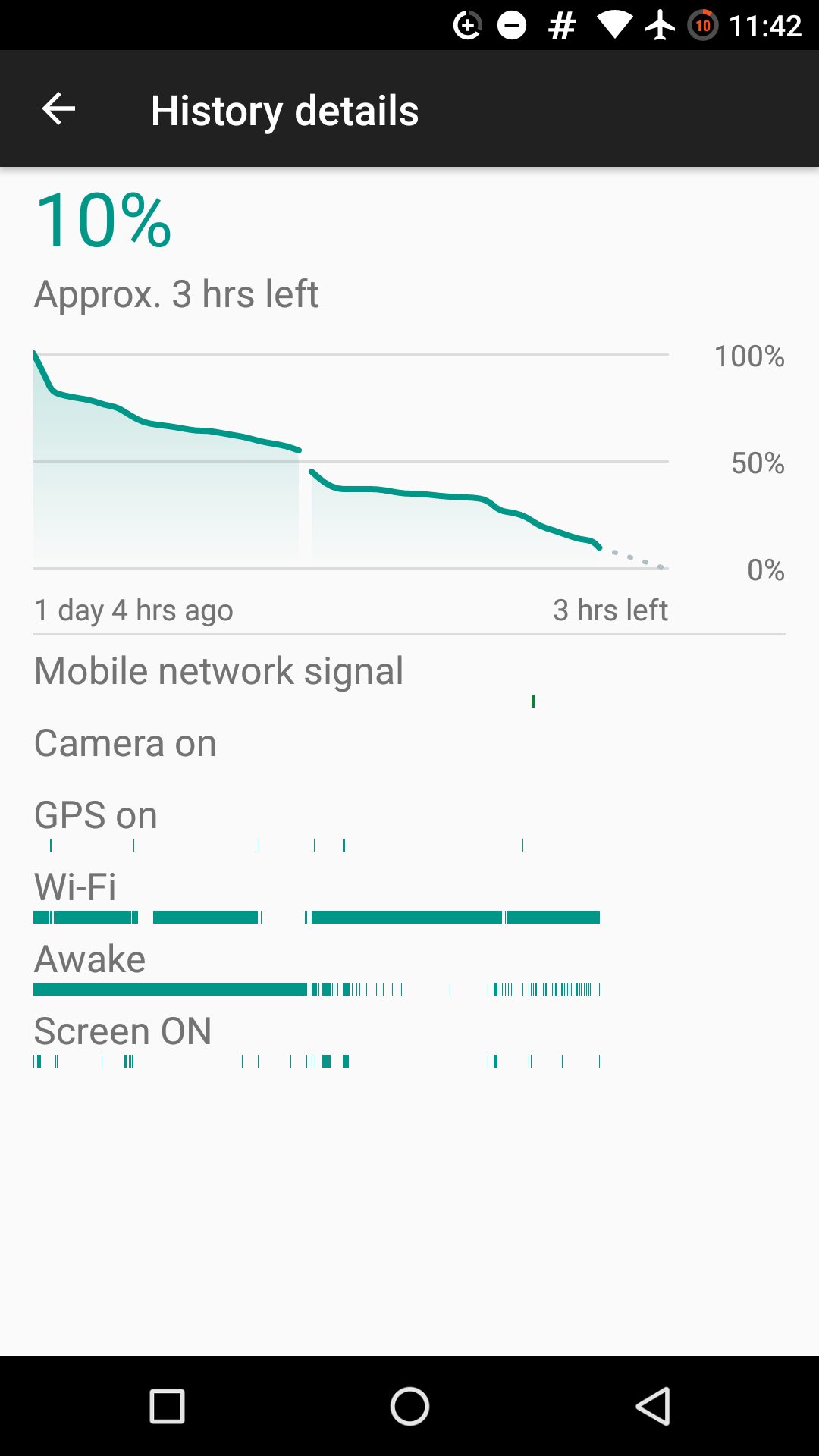

  1. 24.Aug.17 - expected battery duration 1.5 d - roaming but data roaming off, WIFI in sleep on
  2. 24.Aug.17 - almost dead after 28 h - roaming but data roaming off, WIFI in sleep on
  3. 25.Aug.17 - 1d later, expected battery duration >2d - roaming but data roaming off, WIFI in sleep on
  4. 25.Aug.17 - expected battery duration 2d - roaming but data roaming off, WIFI in sleep on
  5. 30.Aug.17 - expected battery duration 21h - back home, WIFI in sleep on, mobile data off
  6. 01.Sep.17 - battery duration 33h - back home, WIFI in sleep on, mobile data off
  7. till 05.Sep, around 20h battery duration - back home, WIFI in sleep on, mobile data on

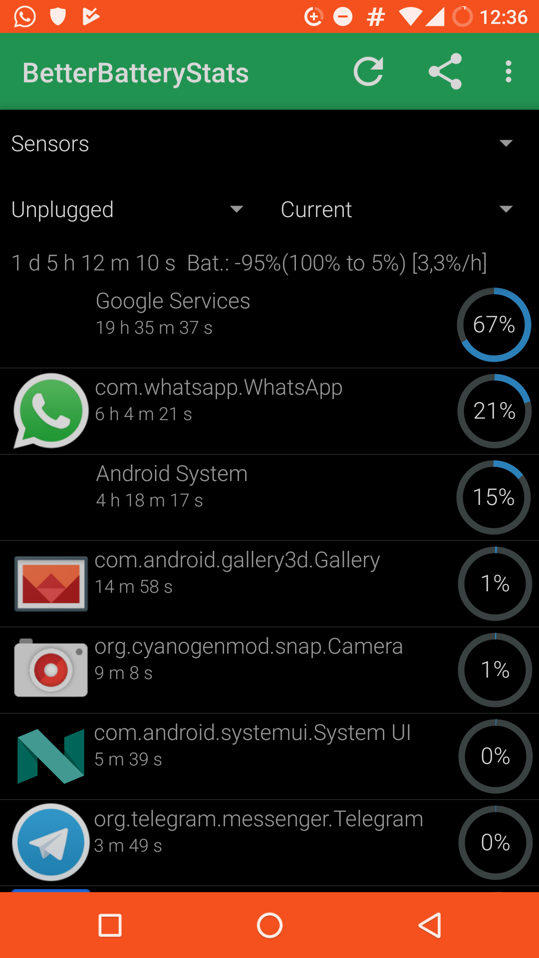

    BetterBatteryStats Screenshots: (SPIEGEL App is my all morning newspaper, that’s why it pops up)
  1. Unplugged - Summery
    2 ) Unplugged - Wakelocks
  2. Alarms&network
  3. CPU States
  4. Process&Sensors
  5. Graphs
    the same as Raw Stats:
  6. Raw Stats - Summery & Alarms
  7. Raw Stats - Wakelocks
  8. Raw Stats - Network & CPU Stats
  9. Raw Stats - Process & Sensors
