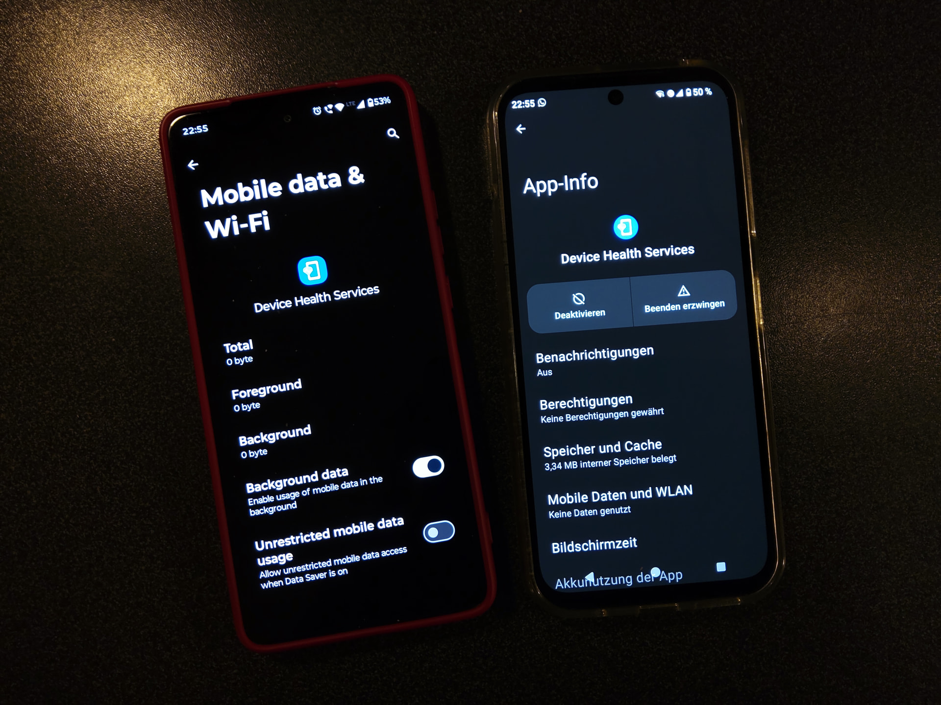

Go to “Settings”, then “Apps”, search for system app “Device Health Services”, open “Storage & cache”, tap “Clear storage” and “Reset adaptive brightness”.
I don’t know if this exists under /e/OS but under FPOS it’s standard procedure for problems of that kind.

Just checked my wife’s FP5 under A14 and my Motorola under A16, both of them have the app running.

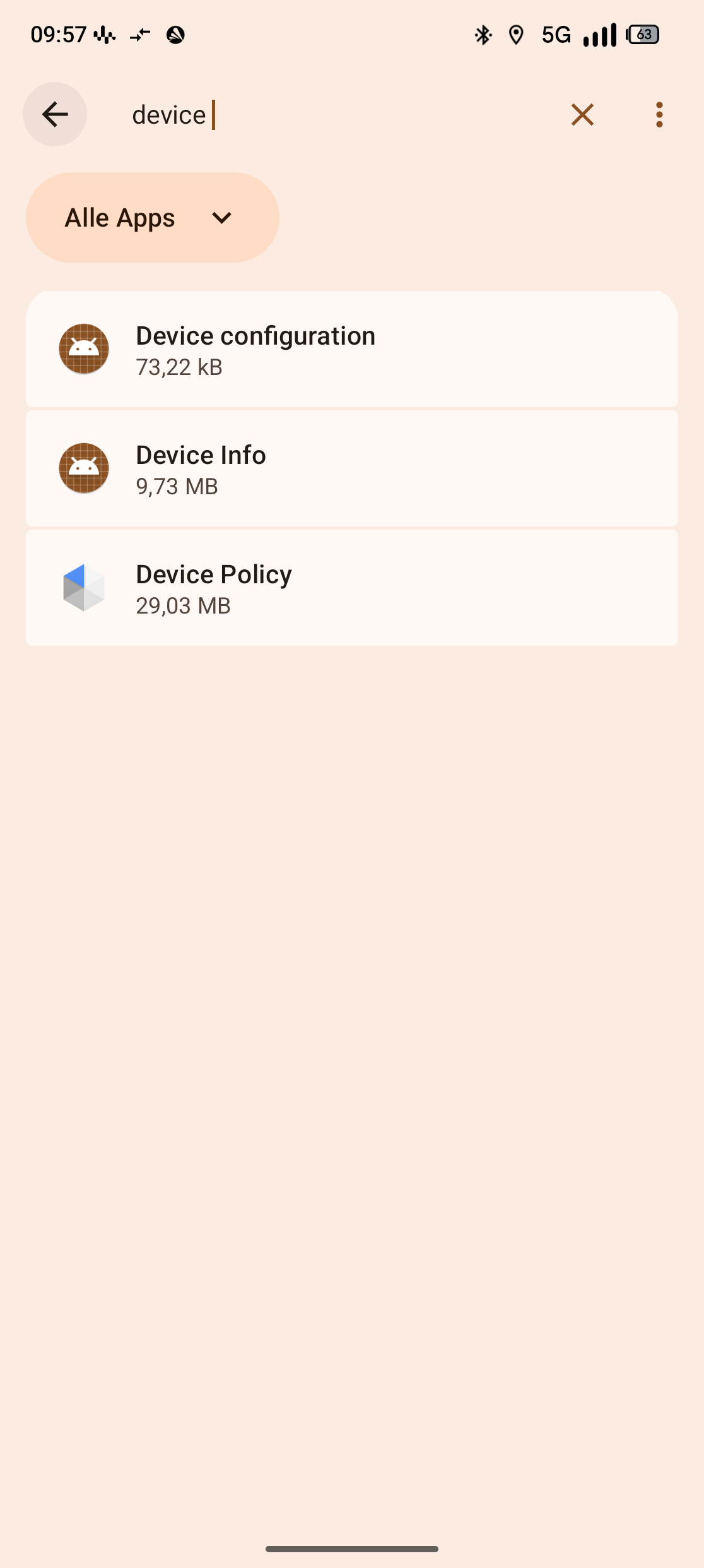

As I’m having similar issues with adaptive brightness, I searched all apps and got no result for “Device Health Services”.
Here’s a screenshot of the results for Device* in all apps.
FP6 A16.

By the way, is “Show system apps” activated in your search? My phone brings up a lot more results looking for “device”.
You dont have a FP6, have you?
Edit: as confirmed above so maybe we should stop trying to find soemthing again and again that just does not exist (for whatever reason)
Yes, “Show System Apps" ist activated, otherwise Device Info wouldn’t be visible.:wink:
